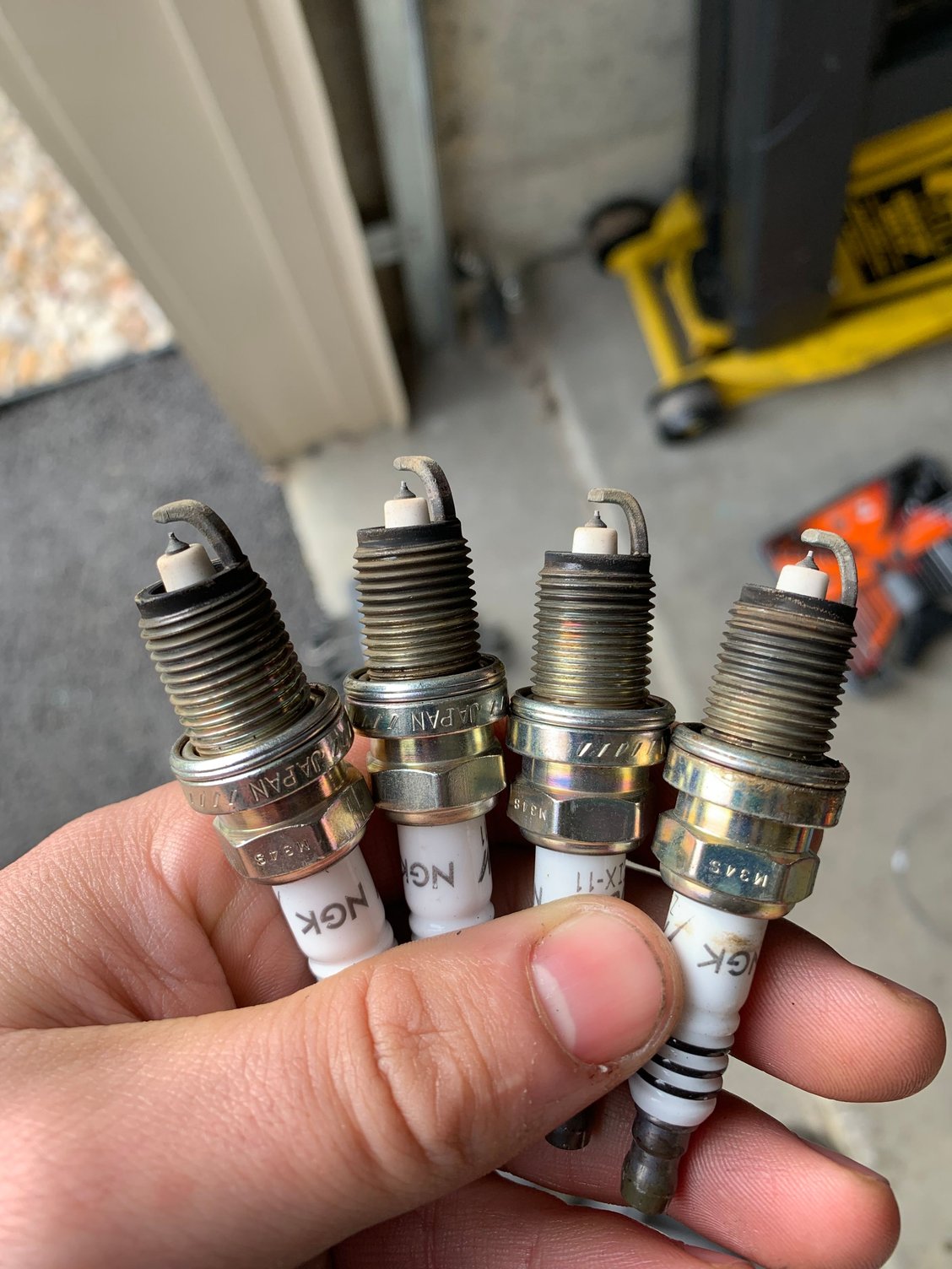

Old Nov 29, 2018
Jnickoles's Avatar
Joined: Nov 2018
Posts: 18
Jnickoles is an unknown quantity at this point
Re: Not your typical surging issue
Originally Posted by Jnickoles
so far today, I purchased a coolant funnel, put the car up on ramps and tried to properly bleed the coolant system. Had the heat set to hot and engine running, when it got up to temp, it just started boiling. Fan never kicked on. I then pulled the plugs as seen above... they look uniform to me. Maybe a little lean? They go left to eight cylinder 4321. Then to see If the fan is working I jumped the t stat housing connector with a safety pin and I could hear the relay switching on and off but fan didn’t come on. I then ran two wires directly to the battery and thouched the fan positive and negative leads. Fan kicked on. Thoughts?
Old Nov 30, 2018
Those plugs were never installed correctly. Not tight enough. Need to be tighter. Won't cause surge though.
Fan fuses? Fan won't cause surge though, but it's still a huge problem.
What about the IAC? Or any other vacuum leak?
Old Nov 30, 2018
Jnickoles's Avatar
Joined: Nov 2018
Posts: 18
how can you tell the plugs weren’t tight enough?... they were very easy to get out. I fixed the fan not coming on... tracked it down to the fuse being blown. Haven’t checked the iac yet and can’t find any vacuum leaks. I found on another forum a guy was having the exact same issues as me, turned out to be his o2 sensors...
Old Nov 30, 2018
Colin42's Avatar
Posts: 9,654
Likes: 1,285
From: Barrie, ON Canada
Rep Power: 223
spark plug gaskets aren't squished down.
can try unplugging the o2 sensors and see if the surging goes away
make sure you do something with the wires so they don't get melted or ripped out
