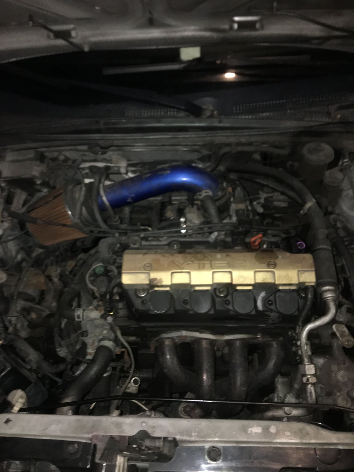

To verify if the car you just purchased has a turbo post a picture of the engine here.

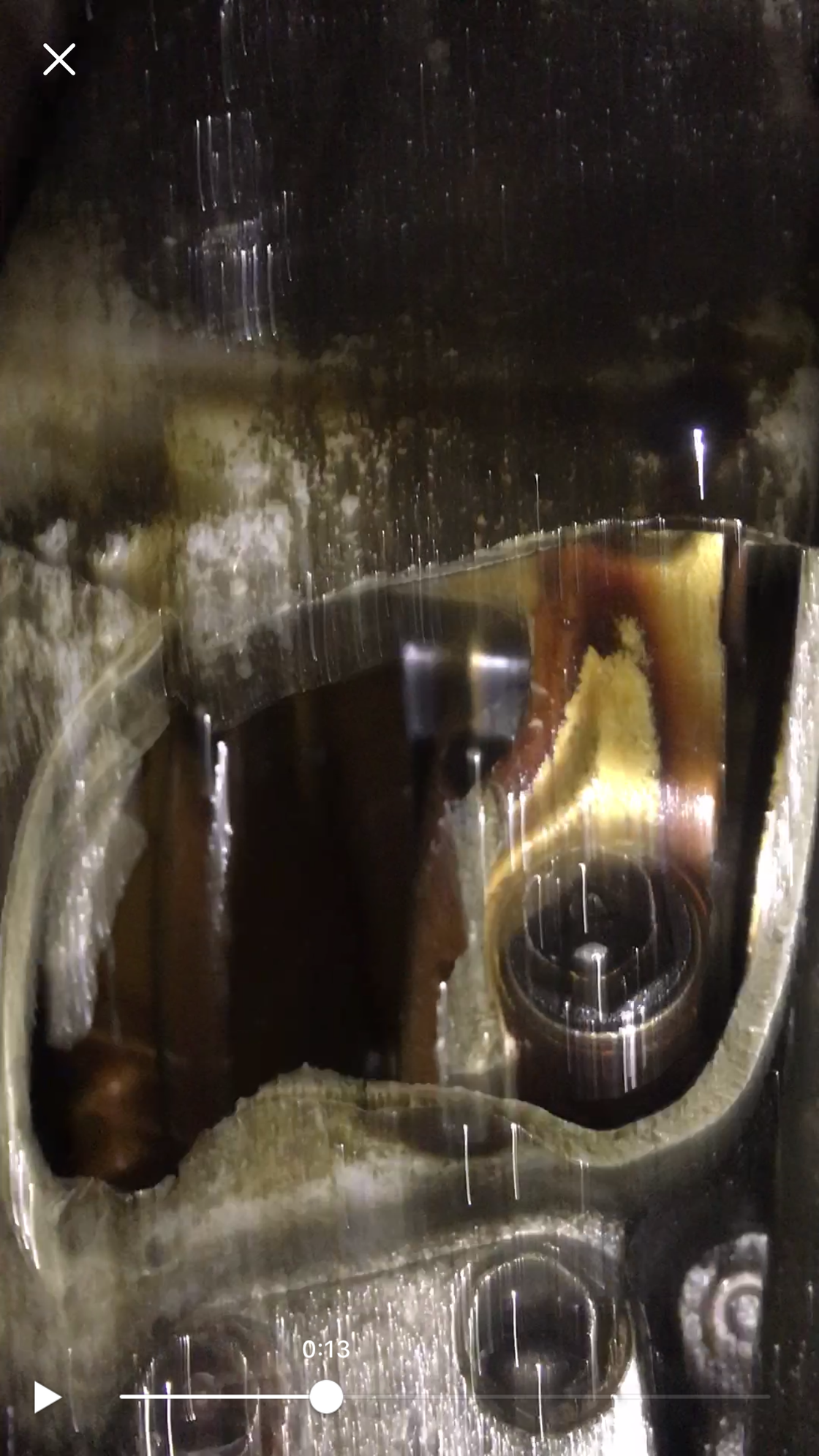

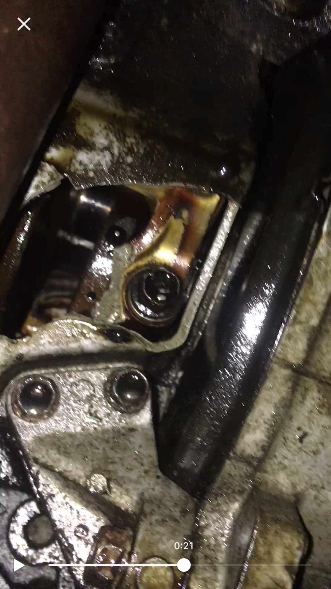

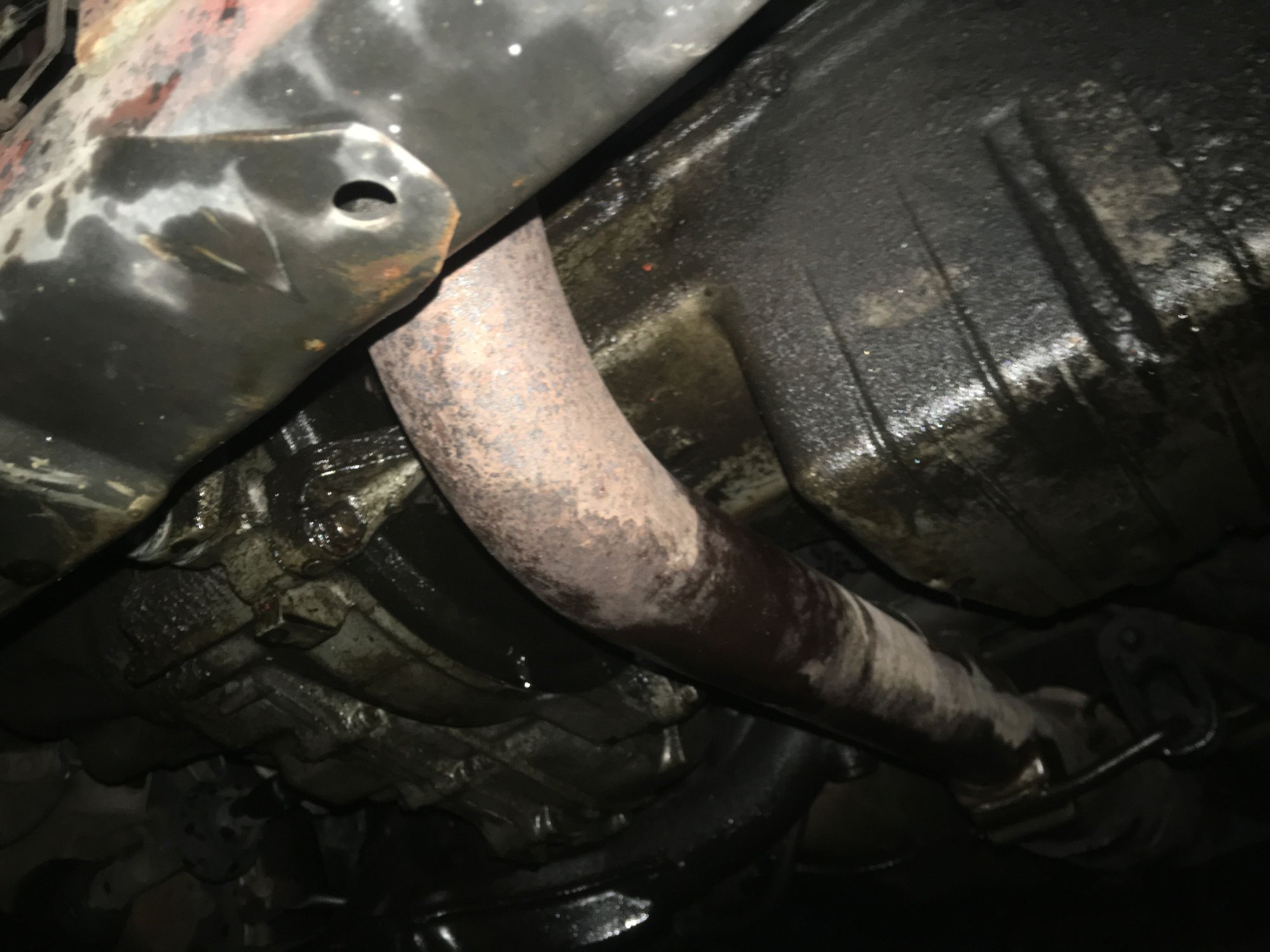

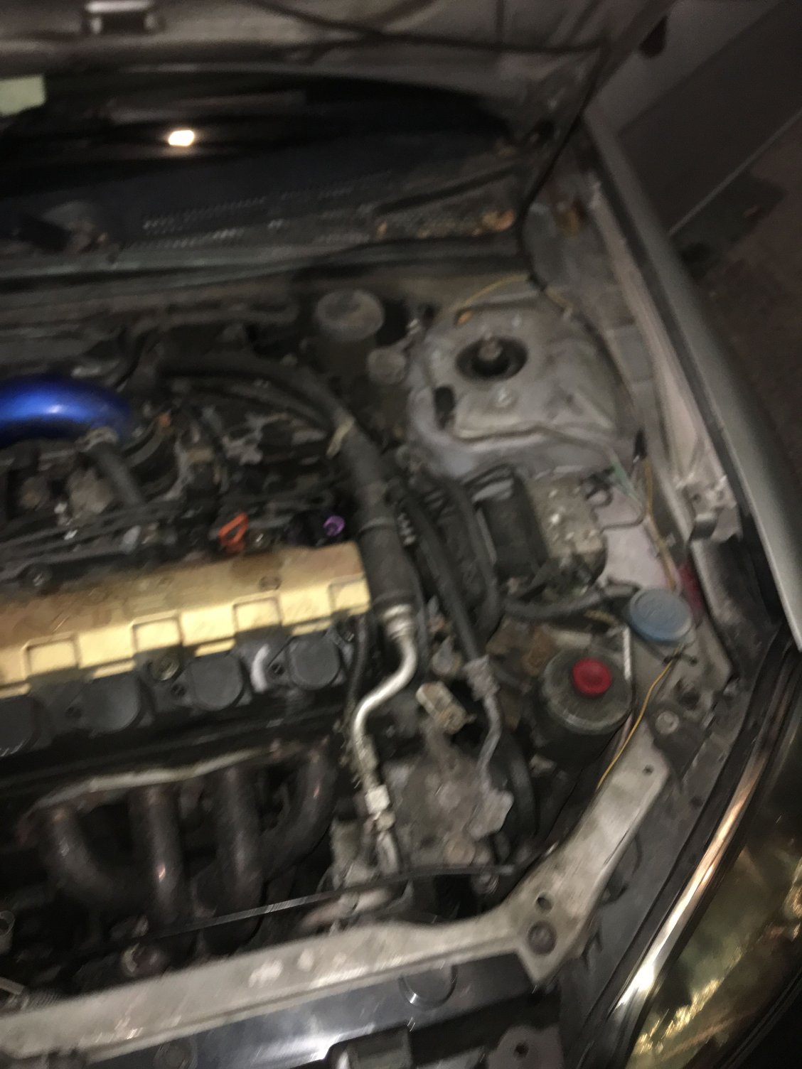

Here is some pictures sorry for quality was hard to take in freezing cold
This all i could see from bottom im not familiar but it looks like something broke here

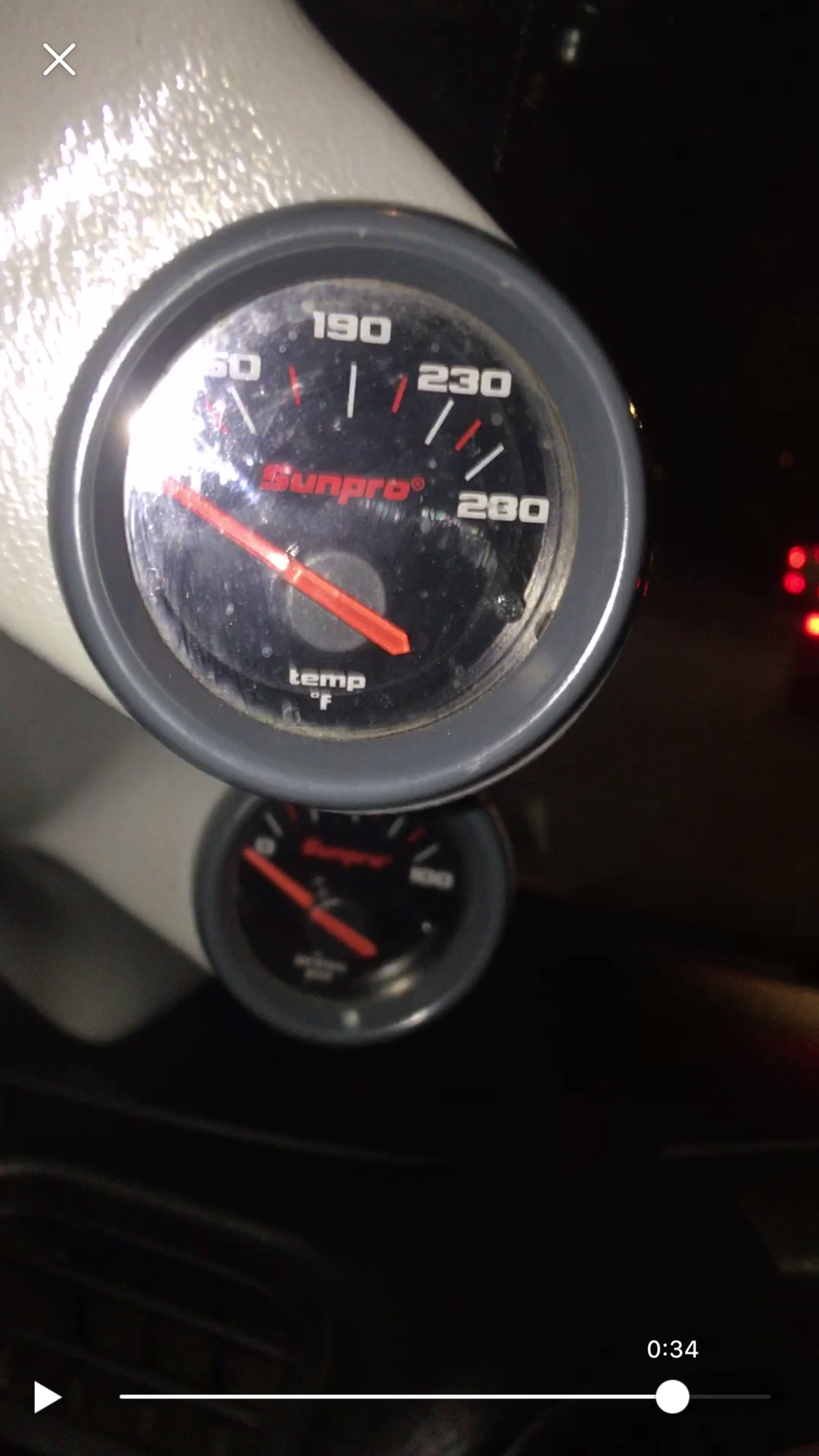

guages in car makes me believe was turbod
Wow..that's neat an oil pan with a peep-hole so you can see how the crank is doing in real time..LOL.
Yea dude..the oil pan (hard to tell pics are to close-up) is blown out. Most likely a connecting rod went through it.
The current engine isn't turbo but, it may have had one prior.
When you look for another engine to swap in..try to find a car that's been in a wreck but the engine still starts up and runs. Hopefully, you have a friend that has auto mechanic experience to bring with you.

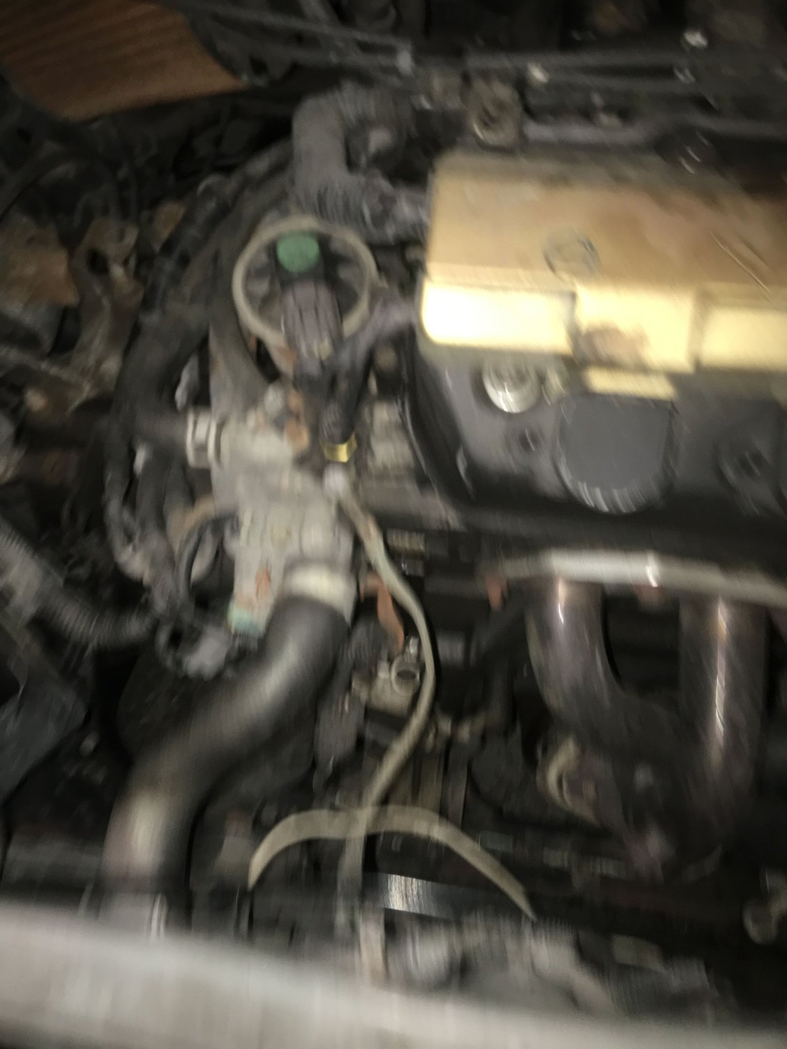

Minor detail but the battery tie-down is installed incorrectly. Hook on the end of the rod connects to the bottom on the battery tray.
