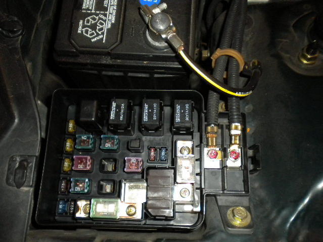

Sounds to me like a faulty fuel pump relay or loose connection at the base of the fuse panel in the engine bay. I would start there, sometimes loose connections can cause intermittent faults, a flashing cel means that something is majorly wrong, it should have stored a cel unless it lost total battery power. I would also check and clean the engine grounds, these can cause all kinds of weird issues, if you know how to use an ohmeter check the resistance from the engine to the negative terminal on the battery if its any higher than 1 ohm I would replace the engine ground straps. Now before you go disassembling anything here are a few easy checks.
1) Check and make sure that they 2 screws in the engine bay fuse panel that hold down the metal plates are tight they are philips head screws.
2) Make sure that the battery terminals are really tight and clean of all corrosion, same for the battery terminals.
3) Inspect all wiring going from the engine to the fuse panel and firewall see if any of the grommets or loom is damaged, if so note where and let me know.
Check and verify those for me then let me know what you find and we can go from there.
1) The 2 screws holding down the metal plates with 2 larger wires are tight.
Also the 4 other screws in the fuse panel are tight too
2) Both battery terminals and tight & free of corrosion
3) Did not see any issues with wiring from engine to fuse panel.
Attached is a picture of the panel.
Let me know what next

Originally Posted by lgs 98dx
Just over 400 miles all was well until today
Check engine light came on coming off the freeway and engine just bogged down especially in lower gears all the way home (about 5 miles)
Checked and Code set was P0505, Idle Control System Malfunction.
This is the same code it set last summer. The IAC valve has already been replaced, although NAPA part not OEM Honda
Erased the code and it did not come back, but haven't driven it on road yet
Also, my code reader has basic emissions readings (green, yellow & red lights)
Since it set the code, the emissions light is now yellow, usually is green
Still yellow after erasing the code
Is any of this related to earlier problem with fuel pump relay?
Any suggestions of what to do next would be appreciated.
Thanks
Today's Update
Drove 50 miles without any issues
Code Tool's emisison light now back to green

1 of 2 things happened either your ignition switch is faulty (try bumping the steering column in park see if you can recreate the hiccup) or try smacking the passenger side right above the glovebox area with your hand see if that recreates it. If bumping the column does it then its the ign switch, there was a recall on them for this issue a while back and it still applies if yours never got done. If bumping the glove box area does it then its the main relay that is causing it. A weak relay will lose contact when bumped hard i try to do it just above the furtherest part of the glove box from the driver.
The receipt for the "main relay" refers to it as an "accy rel". What would an accessory relay have to do with car running?

ok start with this. start the vehicle and hold the rpm's at 3000 until your radiator fan comes on.once the fan comes on let it idle and make sure you have no load on the engine ie. head lights, blower motor, rear defoger ect. your idle should be between 650-750 rpm without a load. If it's between 650-750 you have an interminttent problem. Check for any vacuum leaks and make sure your throttle body plate is closing all the way. If the idle is 550 rpm's or less disconnect your iac plug , if your rpm doesn't increase you have a bad iac motor and need to replace it. If it does increase you need to adjust your base idle to 650- 750. Good luck and I hope this helps.
