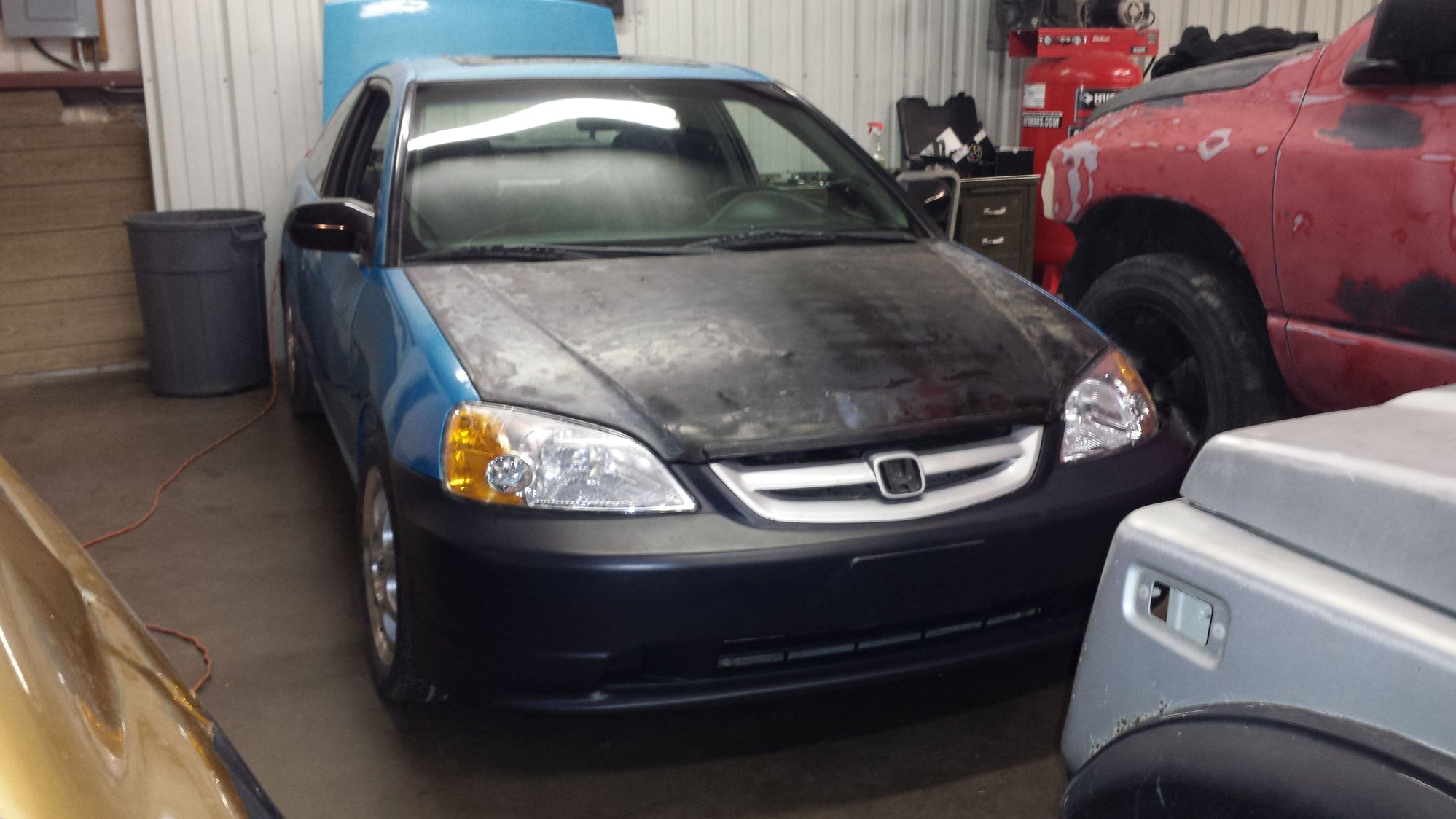

just got project 2002 ex
problems:
1. gear selector hardware hacked up
2. window regulators gone
3. half the gauge cluster lights dead
4. sunroof stuck
5. needs clutch master cylinder slave and clutch set.
6. door panels gone
7. a/c compresor wires disconnected
8. slammed - passanger front slammed extra
9. needs paint job
10. steering column trim loose for some reason.
11. abs light....and srs light.....
12. door chimes inop
13. non-vtech header
14.odometer backlight inop
15.missing key fob
16. door speakers and tweaters trashed
17. is there a dimmer switch?
only 2 fault codes.... p0141..p0135 missing both 02 sensors.
typical problems with a hacked up car?
