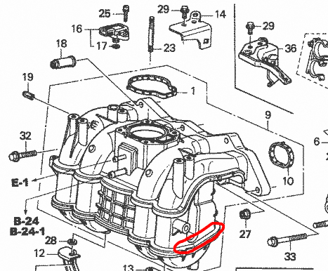

way too dark for pictures right now, but to give you an idea...
Where circled, but opposite side. Also, I think I saw some on the head-block interface on the back left corner of the engine, too. I'll try and get pics tomorrow.

I wouldn't expect a head gasket issue to show up there without a lot more obvious symptoms elsewhere....and if it were, maybe some powder thrown all over the head gasket area would help show the proof.
(The 07 Fit I picked up leaked coolant all over the top of the trans, but the engine had to be hot before it leaked....and I found a broken head bolt in the same corner.)
Didn't you have the issue with missing bolt(s) on the water housing on the end of the head? Could it have come from something in that area, or maybe a heater line?

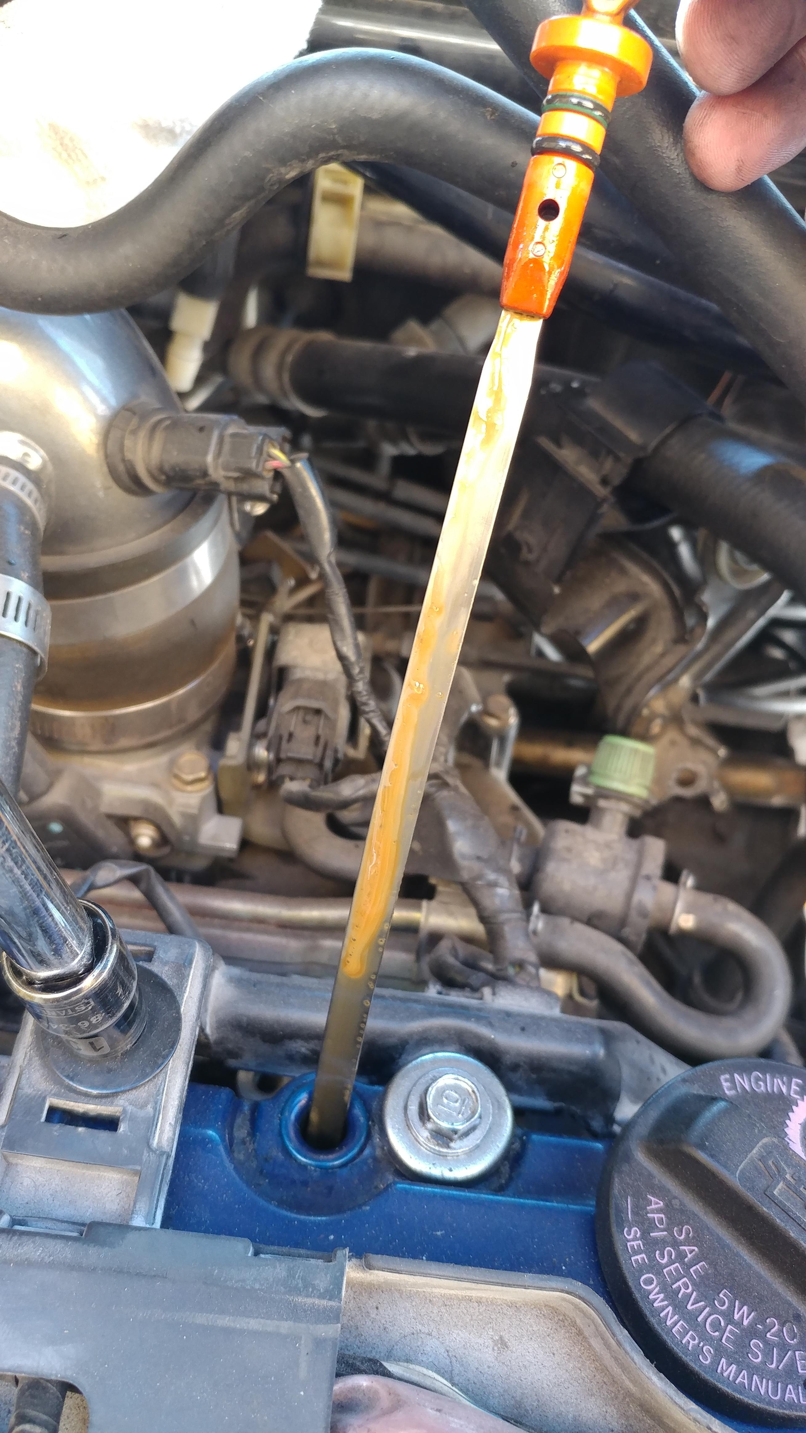

Head gasket leak confirmed via chocolate milkshake.

PSA: Your oil is not supposed to look like this
