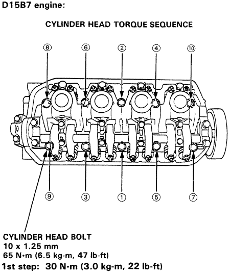

One thing that was a bit disconcerting. I have head studs, and I checked torque after 2000 miles and again at 5000 miles after installing. The disconcerting thing was 2 of them took zero effort to loosen when I was taking the head off.
The ones at number 5 and 6 were the ones in question. However, all the signs of leakage were on cylinder 1, whereas the ones in question are below and above cylinders 2 and 3, respectively.

Would it be safe to helicoil the head bolt holes? If not, I'm gonna blow my car up.
Old Oct 7, 2017
  #36
Rep Power: 520
Re: Head Gasket
Are any actually stripped?
Sure, it's an iron block. If you can find the appropriate thread size and it doesn't look like it will be scary thin, go for it.
(SOME engines have unusual size head bolts)
Also, time-sert is a great thread insert IMO but probably more expensive to start with a whole kit

You sure its iron? I thought it was an aluminum block. 3 of the 10 are stripped out of the block. Stripped out at 14 ft-lbs, that is

In any case, I'm gonna have to figure out how to either helicoil it or timesert the affected holes. Timesert seems like a better fix, but I'd have to get crafty with installing them since the threads are about... a half in deep, and the timesert is designed to sit flush with the surface..

On my old D16Y8 (6th gen) one of the head bolt block hole's was stripped. I drilled out, tapped the block hole and used one and a half helicoils (M10 x 1.25 kit IIRC) one on top of the other. I called the manufacturer and a tech said it's okay to stack them that way. He also said it's okay to use red thread locker to keep them in place if the head needs to be removed and replaced in the future. I wanted to get as many coils on the head-bolt threads as possible and stacking them accomplished that.
Not sure if the depth from the top of the deck downward on a D17 is the same as a D16? Hopefully it is.

Yep, m10-1.25
Howd you get the other helicoil all the way in? They're ranged at the bottom to help install the bolt, no? Just snip one and use a scribe or something to drive it in?
Man, I can barely recall what I did last week let alone three years ago when I did that head gasket..lol.
1) IIRC: I used a small diameter drill bit to measure depth from top of deck, used a ruler to measure depth in millimeters from above mentioned drill bit.
2) When using the recommended sized drill bit listed on the helicoil kit I used tape to mark the depth in millimeters (from #1) to mark stopping point.
3) I used the same measurement (from #1) and tape on the tap tool to mark stopping point.
4) I used the same measurement (from #1) to mark the length of total stacked helicoil..which ended up as roughly one and a half. Unfortunately, I can't remember whether I inserted the 1/2 sized one or the fulled sized one in first. I cut the (half) coil with a very good quality Craftsman small dyke tool: https://c.shld.net/rpx/i/s/i/spin/im...&wid=64&qlt=50
As far as the tangs I think I suctioned them out with my good ole' (20 years old) Kirby vacuum.
You could call whoever manufacturer's helicoils and ask them if they have longer ones (single piece) in the same diameter and pitch needed. PDF chart: http://www.helicoil.in/pdf/HeliCoil%20Catalogue.pdf
Here's a related thread..see reply#2: https://honda-tech.com/forums/tech-m...nserts-818532/

One of the guys in our shop tried to put double helicoils in a V6 head bolt hole and couldn't thread the bolt in afterwards.
Ended up pulling one of them back out and just running with the single helicoil.
I can only assume it is still on the road.

Installed 5 helicoils: 3 to repair already damaged holes and 2 as a preemptive measure for 2 questionable ones. All 10 survived round 1 of training. 2 repairs holes failed round 2, as did a third unaltered hole.
I'm just ducking done.
