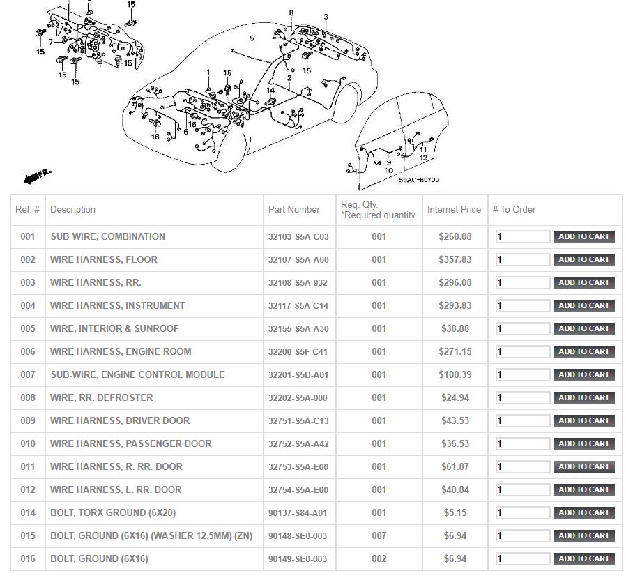

What is the part called? Do you know what part number it is from honda? (just to get an idea)

this is for an 05 4 door
Name:	door wiring.JPG
