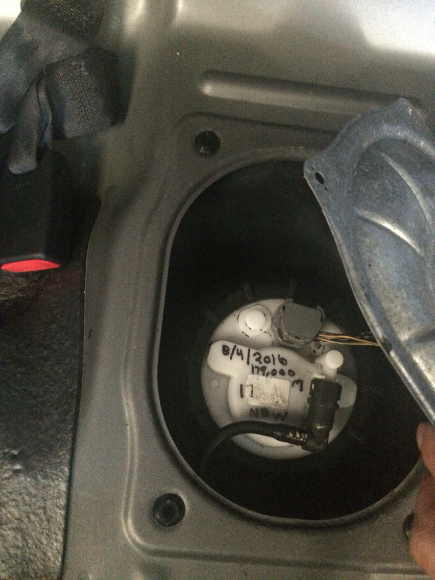

I just did mine not too long ago on an 05 due to leaking
