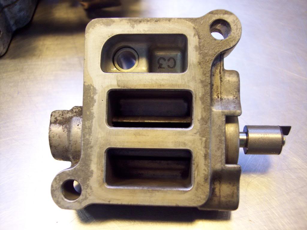

If you remove the electric portion from the IAC valve, there should be delicate a little shaft sticking out you can use to rotate the valve with your fingers.
Odyssey part, but yours should be similar:
The holes for the two bolts are probably slotted for adjustment of the electric portion, but there is no written procedure to adjust it.
Mark the exact position of the electric part so it can go back on in exactly the same place it began.
