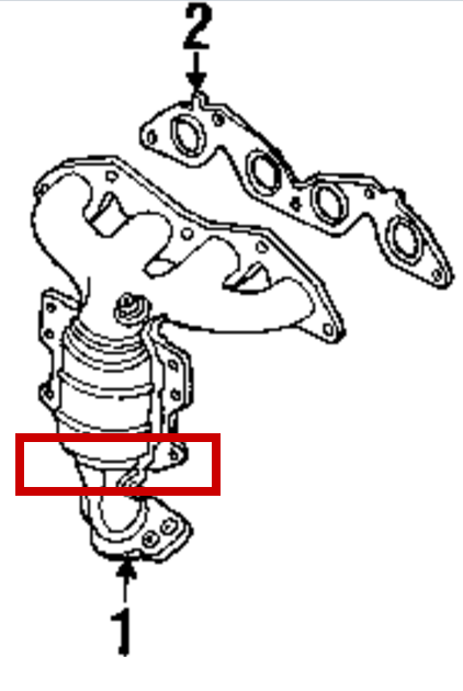

The car starts right up now, sounds a lot smoother less hesitation on the start. The engine sounds like butter. When I started it today the tachometer went to 1.5rmp right off the get go, so I guess that's a high idle. Then about 20 seconds after the start, the tachometer began to climb to about 2 then 2.5 while simultaneously smoking at the header area of the exhaust manifold, seemed related. I found an image and highlighted where I saw the smoke coming out of:
Weeks before I let the car sit for an extended amount of time, the car threw a code and the guy at advanced auto parts said it was an O2-sensor, I heard that the upstream 02 sensor is what regulates air and fuel ratios so could that be causing the high idle and smoke around that area?

Name:	Screen Shot 2016-07-23 at 9.09.13 PM.png

Re: Smoke coming out from engine after alternator replacement?
No it can't cause high idle.
The smoke is probably just crap that needs to be given time to burn off the exhaust. You gotta get the thing out on the road and drive it for a while to do that.
The high idle: Does the idle surge repeatedly?
Do you have some slack or droop in the two throttle cables, neither is pulled tight and holding the throttle blade partway open?
If cables are not the issue....
Remove the lid from the air filter box. Start the engine and let the idle climb. Twist the throttle toward the fully closed position just to make sure the cables aren't holding it slightly open. (throttle blade must be completely closed)
Then use your fingers to block the hole in the inside of the throttle body (this is the air passage for the IAC valve). Does blocking the port cause the idle to drop to normal speed or lower?
