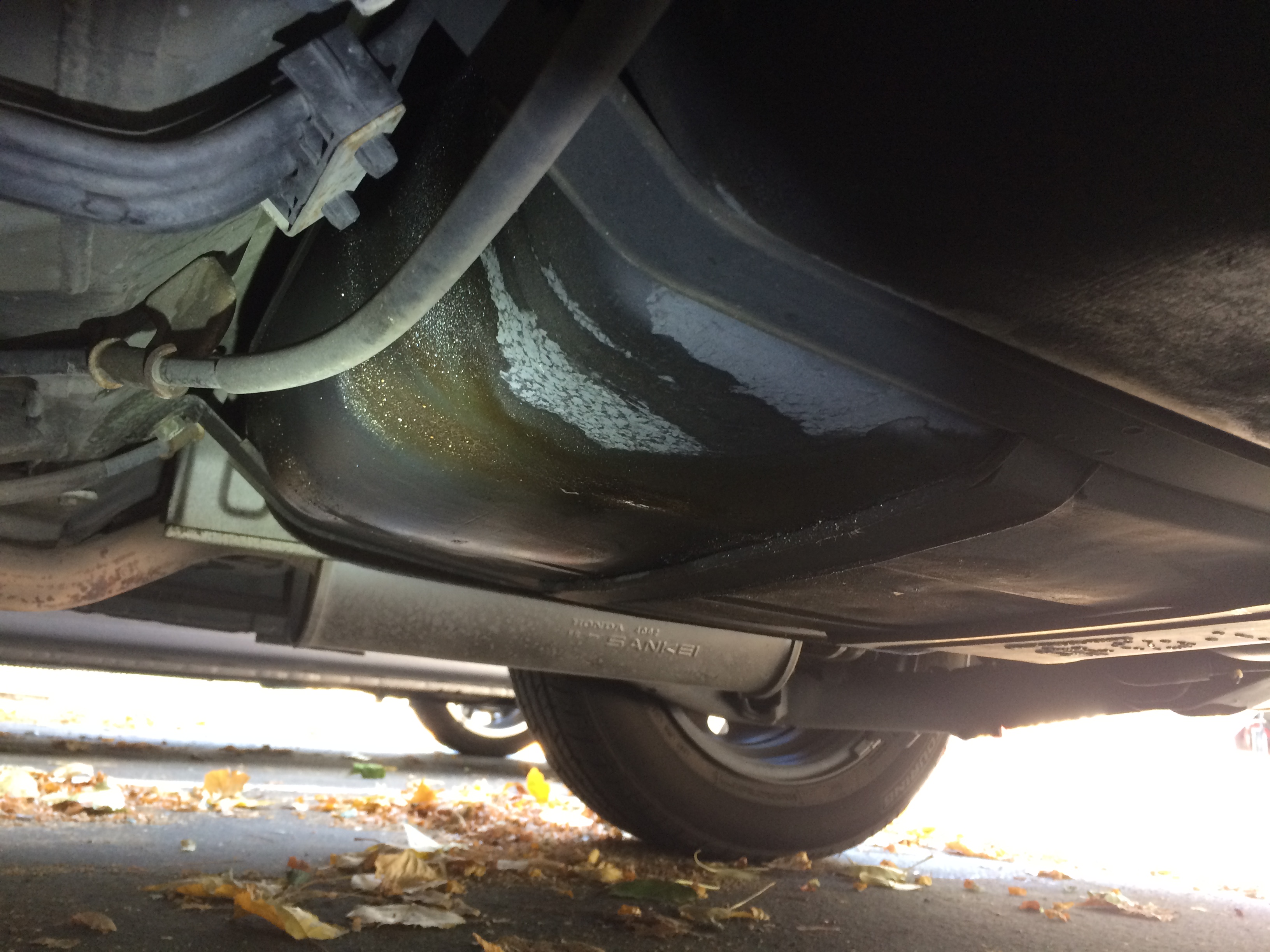

Well, jacked the car up and saw a sizable leak coming from the gas tank. Not sure where the leak originates from. Maybe I could drop the tank a little bit to get a better view.
I've attached a picture. What would be a probable leak point towards the top edge of the tank?

Re: Civic stalls and smells like gas
Maybe pull the back seat out first and see if it originates from around the fuel pump.
*cough*
Originally Posted by ezone
Pull the back seat and inspection cover and look at the top of the tank/pump? (cracked pump cover?)
I'll add the possibility of rodent damage, they seem to like some of the plastic fuel lines over here for some reason.

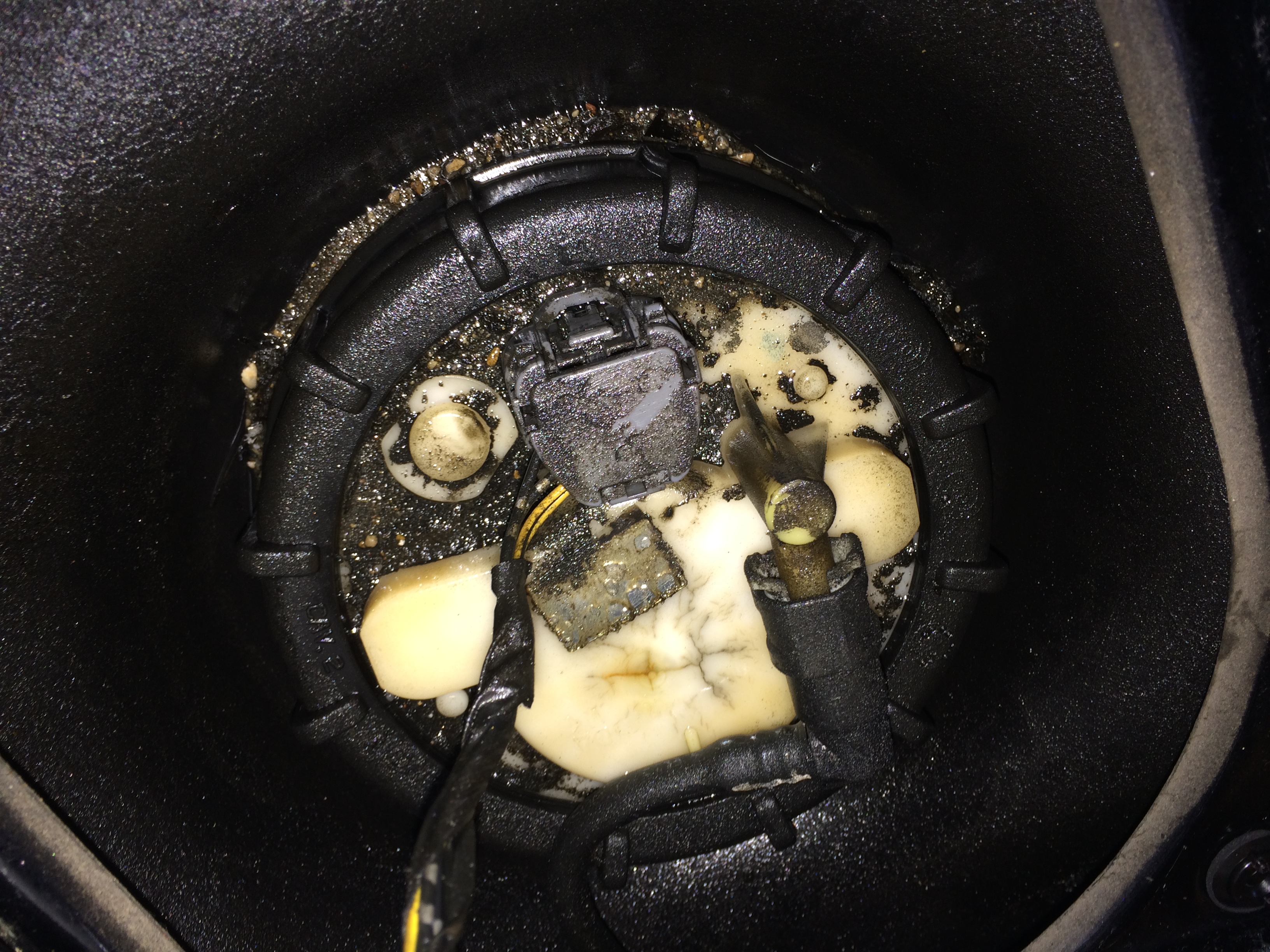

Alright, I've spotted at least part of the leak. Removing the access panel shows the following (see attached).
Does this mean replacing the fuel pump?

Old Jul 11, 2016
Dry it all off then cycle the key and see if gas is coming up through the cracks in the flat yellow area.
That housing is the fuel filter, it can be purchased through aftermarket sources without the fuel pump but some people have issues getting it assembled correctly.
Honda only sells it with the pump assembly.
Done. See the following video:
https://www.youtube.com/watch?v=6mvg...ature=youtu.be
Old Jul 11, 2016
Ayup, it's junk.
This can be fixed without removing the fuel tank, which would have been a whole lot of unnecessary work. That entire unit will come up through the access hole.
You just need the right tools to get the threaded ring unscrewed....then reinstalled after repair.
Quit running/driving it. You're a fire hazard.

Thanks ezone for your help. I've replaced the fuel pump assembly and no more leaking. However, I noticed when I got in the car yesterday, it still had a smell of fuel. Putting my nose to the fuel pump assembly (access plate removed), I smell fuel. Is this normal? If so, does the access plate and seat act as a buffer to the fumes normally?
