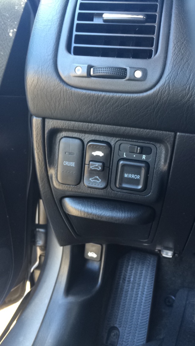

How to change my cruise control bulb?
Im not sure if I have to pry it out.

Little pocket underneath, open it up and look up. There's a screw there. Remove it, the cruise/mirror/sunroof switch assembly comes right out. Look on the backside of the cruise control module, you'll see the bulb bases there. 90 degree twist unlocks it, should come right out. Have fun finding bulbs for it. I converted mine to LED

My dealer usually has a few of the bulbs in stock.
