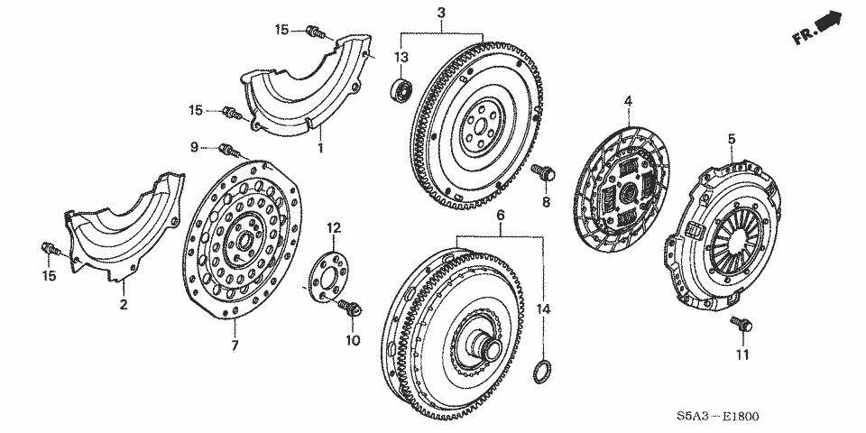

Sounds like a pain to get to. After a few googles, all the videos that reference replacing a pilot bearing all show the transmission out of the car. So I'm assuming I need to drop the trans in order to replace this bearing?
I was hoping to get to it with just separating the trans from the engine. It looks like the bearing is inside the middle of the flywheel but maybe that's just how it looks from the diagram. I assume it's part 13 from this diagram?
You were going to drop the trans to replace the throwout bearing anyway, yes?
Which wouldn't fix the problem (assuming I'm correct).....and then after cussing a lot you would be removing the trans a second time to fix the problem.
Taking the flywheel off and replacing the pilot bearing is only like 20 minutes (GUESS) of extra work beyond a clutch replacement. It's driven into the flywheel from the crankshaft side of it, so the flywheel has to be removed to replace the bearing.
Item #13, yes.
