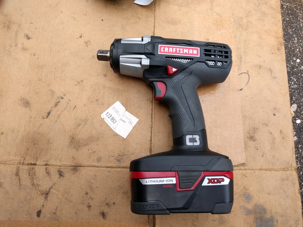

I bought a craftsman 1/2 19v impact. Removed crank bolt right away. Was a great excuse to add it to my tool collection
That's a great idea. Thanks.

The battery impact I bought:
Nice! Sears is selling them for $90! Did you use this to retorque the bolt, and if so, how did you avoid overtorquing it?

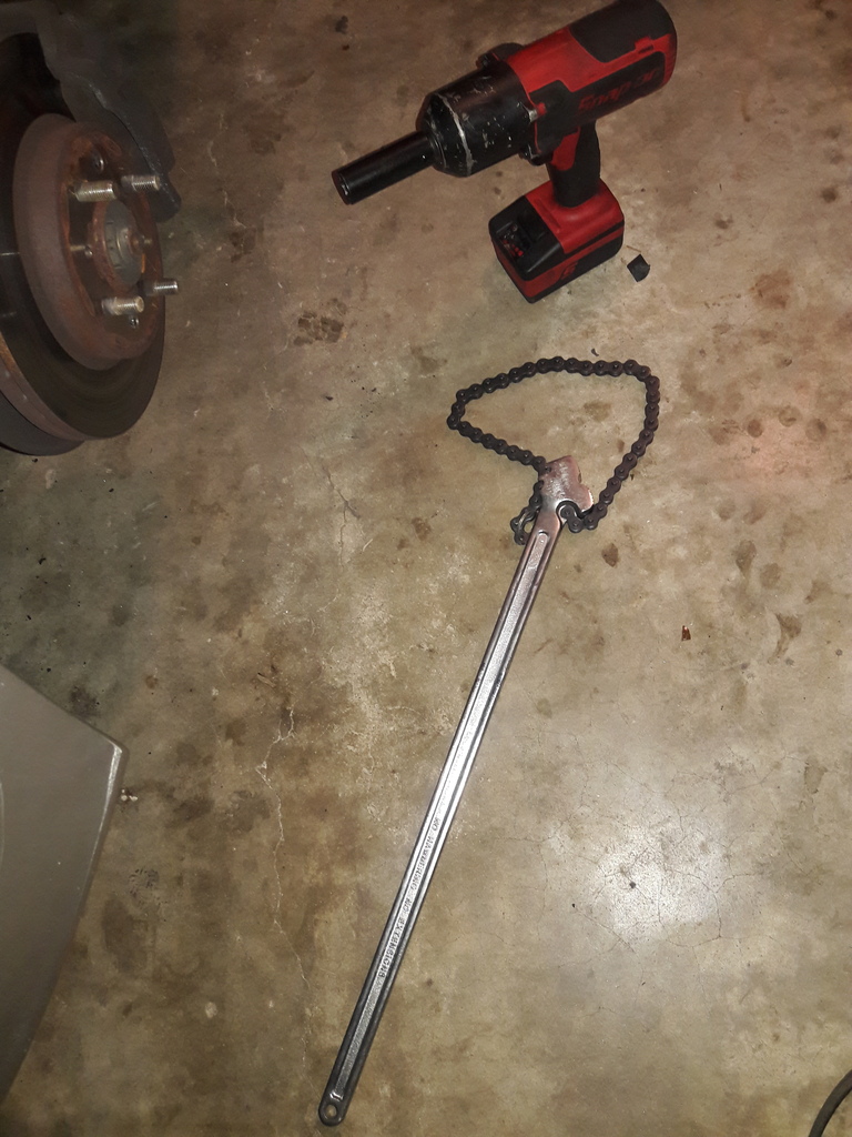

This is the tool I used on my 240 to hold my harmonic balancer. Also worked well with my wife's 2001 civic.
Not sure if you can get it anywhere but the snap on truck but it's the best tool I have ever had.

And this.

Thanks very much for posting that, it looks perfect for the job. Great photos too!
