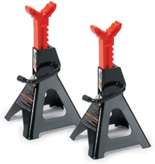

I believe the owners manual would have you use this in the event of a flat tire.
Supporting safely on a less than ideal surface is a matter of spreading out the cars weight over a large area to reduce instability of the ground surface it's resting on....and you really shouldn't use another soft material to do it.
The scissor jack, a floor jack, a jack stand all have very little surface area on the bottom, they are intended to be placed upon a solid base. The bottom of most jack stands would slice right into the ground like a knife, like standing on a shovel in dirt.
If you drop the weight of a car onto a jack stand on thin plywood, it might be able to rip through and that's not stable. How much does the car weigh, how much of that weight is gonna be placed upon the stand, and will your flat surface hold up under that weight?

edmunds.com said it weights 2403 lbs.
I didn't care about a real number, we all know a car is dang heavy. I just wanted you to be aware and use your head before you get into a bad situation.
The jacking point could conceivably have over a half-ton of weight on the jack or the stand, and the ground. All that weight on such a small contact area on a soft surface is not good.
The legs are just stamped steel, they are probably made of about 1/8" thick steel. The shape gives plenty of strength, but the bottom is wide open.
If the total exposed surface area of the bottom of the jack stand is (example, guess) 1/2 of a square inch, that calculates as 2000 PSI trying to dig holes into the dirt with the base of the stand.
Like a cookie cutter with a ton of weight pushing on it.
It will easily dig a hole for itself and cause the car to sink, or as the stand settles it can tip unevenly and cause the car to fall off of it.
The rest of your plan sounds good.

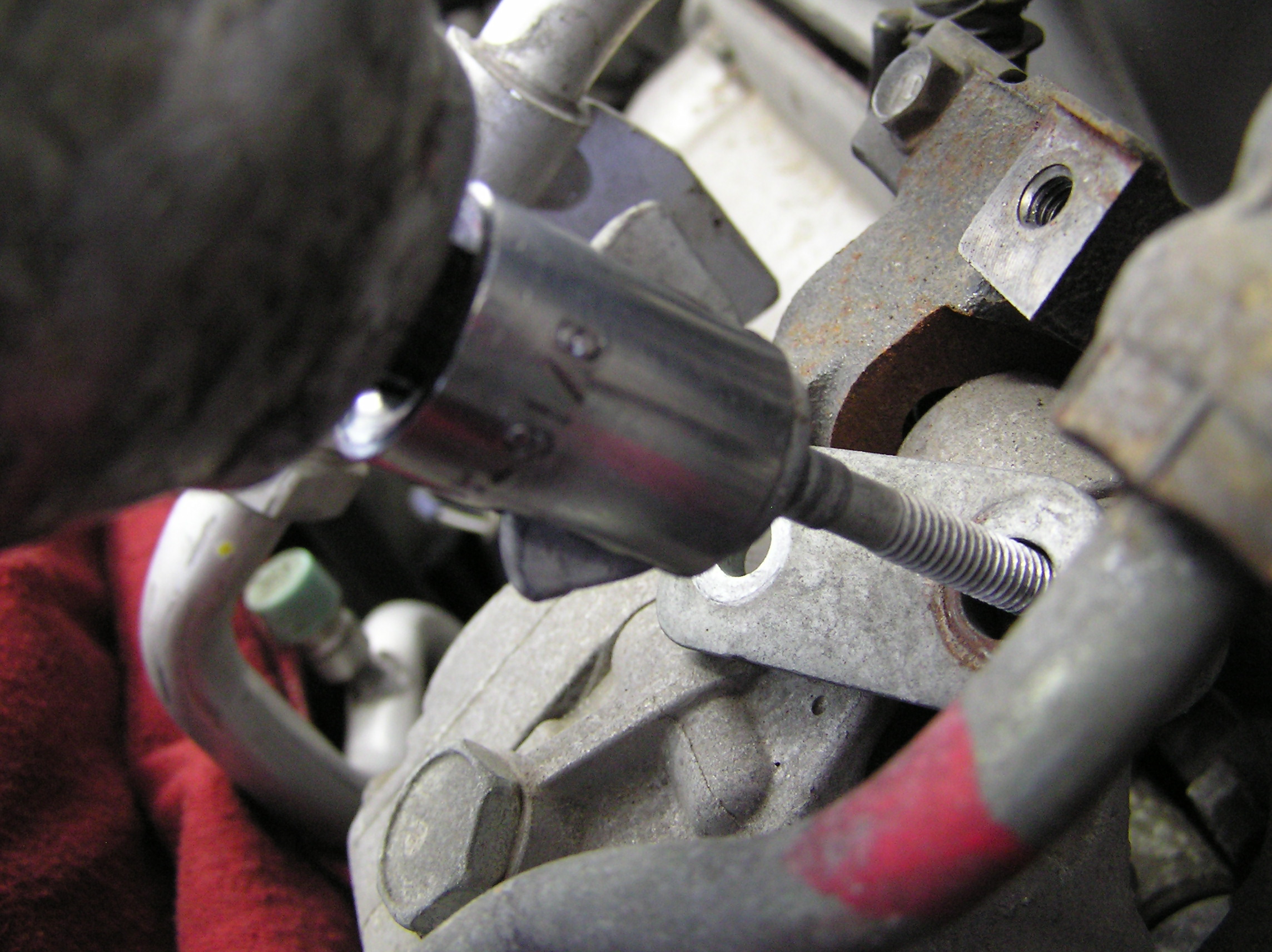

Re: Is it ok to use a scissor jack instead of a floor jack?
Loosen this bolt (14mm head) about one turn so the alternator isn't locked in place
(It will still be tight to move, but not impossible)
Then loosen the 12mm head bolt (blue)
and adjust using the long one (either 10mm or a wing head?)
Tighten all to spec when done.
New belts can stretch, they may need readjusted soon after install.
That 10mm wing nut seems to be the hardest part right now. Does the 14mm alternator bolt and 12mm head bolt need to be loosened for the thing to move? I know the sequence follows that order but I was wondering if it just a stubborn rusted bolt or if the sequence has to be followed first for it to turn. I think you were referring to a wing nut socket? probably going to pick up a universal one.

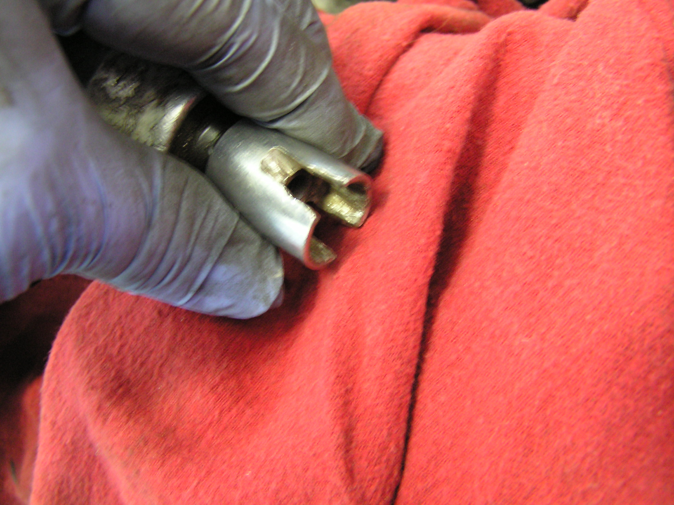

Uhhhh, it depends.
The loop that holds the threads could be in a bind due to the other fastener, and as you try to turn the thing it will be trying to move the entire alternator along with the belt tension.
I see a lot of those that have their threads seized up, when I do timing belt jobs.
If I think about it while doing that job, I may spend a minute to free it up before putting it all back together, but I rarely even use it when I assemble and install the belt. I just use a prybar to move the alt from below, and tighten the bolt when I like the tension on the belt.
Some years used a 10mm head on the adjuster bolt, other years used wings. I never remember which years used which style.
I wasn't referring to a special socket, but I made a socket for the wingnuts and bolts with wing heads.
I cut out slots in the sides of a cheapo 9/16" socket.
