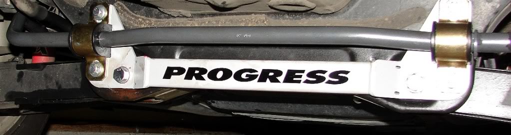

PS: Mac25 and me are running very thick rear sway bars (Mac is on RSX, I am on Progress) and we DON'T run the front sway bar and the car is still understeering!!!
highly recommend this mod (not maintenance, being why i did not mention until now )

Understood, and a suggestion to consider, definitely.
My car seems to have much less understeer than the '90 Integra, or other similar cars. Not exactly what I expected in that regard.
I suppose I won't know what's up with that until I get the rear links installed. Alignment, maybe. I may have to go "test drive" a couple others to see if it is typical of the breed,
