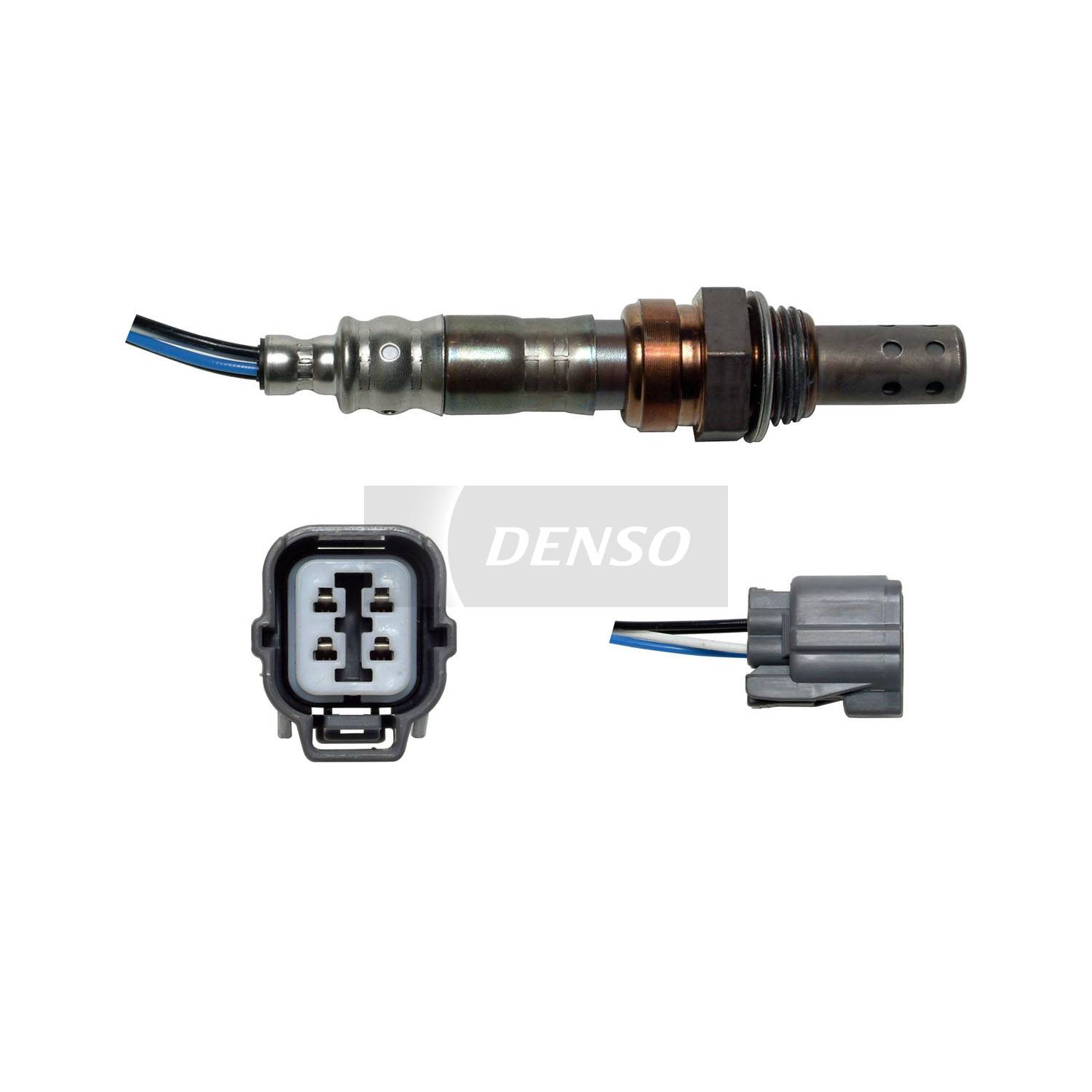

You can obtain the OEM sensor through other sources than the dealer but you have to know what you need first.
Got your engine code?
http://densoautoparts.com/find-my-pa...icle-selection
Visit the DENSO website and look up the A/F sensor number
then you should know what to search for purchase
wait...here
Trim: L4 (1.7L)
Eng: D17A6
234-9005 (1)
D17A6 Engine|DENSO is the O.E. Manufacturer / Air Fuel Ratio Sensor
Position:Upstream
Label:OE Style
Trim: L4 (1.7L)
Eng: D17A1
234-9005 (1)
D17A1 Engine|DENSO is the O.E. Manufacturer / Air Fuel Ratio Sensor
Position:Upstream
Label:OE Style
Trim: L4 (1.7L)
Eng: D17A2
234-9017 (1)
Installation GuideLA990009-1407.1
D17A2 Engine|DENSO is the O.E. Manufacturer / Air Fuel Ratio Sensor
Position:Upstream
Label:OE Style

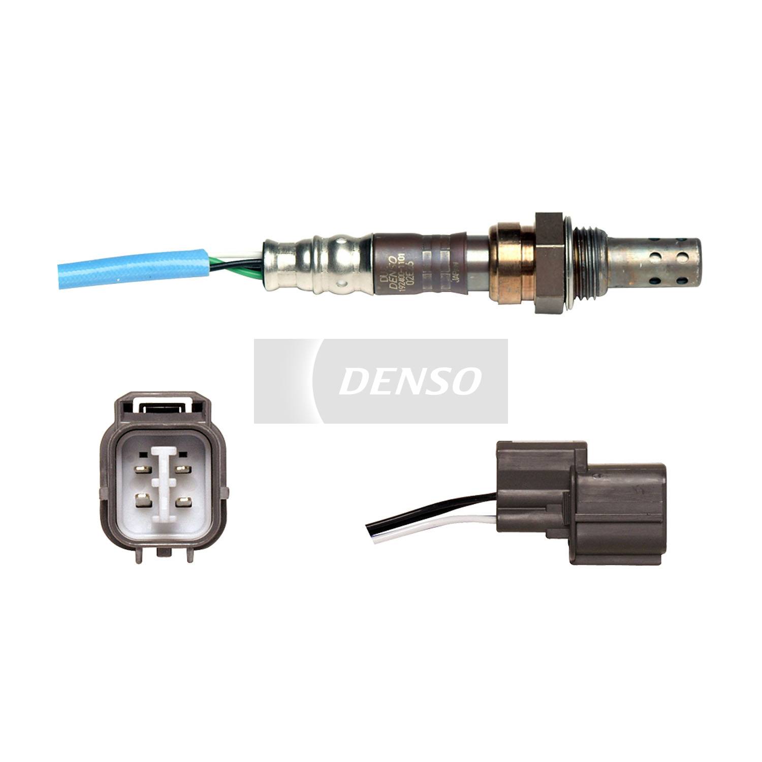

My car is now throwing P0139 code. I think now its rear sensor. Can someone please help me to find the part number from denso and NGK for this? Secondly, how much it will cost to change the sensor.
Thank you.
Old Sep 26, 2015
Re: Honda Civic 2005 check engine light ON
http://densoautoparts.com/find-my-part/vehicle-selection
http://www.ngksparkplugs.com/part_fi...t.asp?mode=nml
Old Sep 26, 2015
wali's Avatar
Joined: Aug 2015
Posts: 9
wali is an unknown quantity at this point
Thanks a lot for quick response. I tried this one but shows many options, i.e., pre-cat and post-cat. I am not sure which one is the correct part no.
Old Sep 26, 2015
P0139 O2 Sensor Circuit Slow Response Bank 1 Sensor 2.
Sensor 2 = Rear sensor = secondary = "post-cat" (even if it is stuck in the middle of the cat on some of the cars)
HTH
Old Sep 26, 2015
wali's Avatar
Joined: Aug 2015
Posts: 9
HTH
