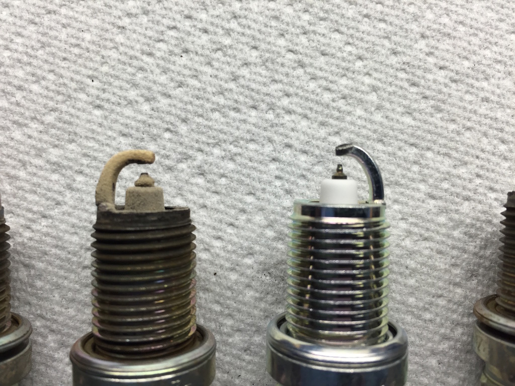

The plugs are definitely not fouled enough to cause any misfiring or rough running, but they are old. Should I still consider replacing them? I haven't found the receipt in my file to verify their age yet.

New Plugs? (I'd be happy to post a photo of one of mine)

Precious metal plugs are supposed to be changed at 100,000 miles, but in reality they may outlast the car as long as they don't get fouled.

Here's a shot of my plugs. I'm not exactly sure what to think, but I suspect the are fouled by the oil consumption and perhaps past their prime? Old on the left, new on the right (duh).

Ashy coating on the plugs, not heavy, probably would attribute to slow oil burning.

At any rate, all this kinda points to rings, as expected.
If the oil consumption rate becomes so great it is fouling plugs and causing misfires, I'd switch to (much cheaper) copper NGKs ZFR6F-11 and change them out whenever needed.

Carbon on top of the piston, also expected. It's supposed to become "self cleaning" once it builds up to a certain level, meaning once it builds up so much it doesn't accumulate a bunch more.
