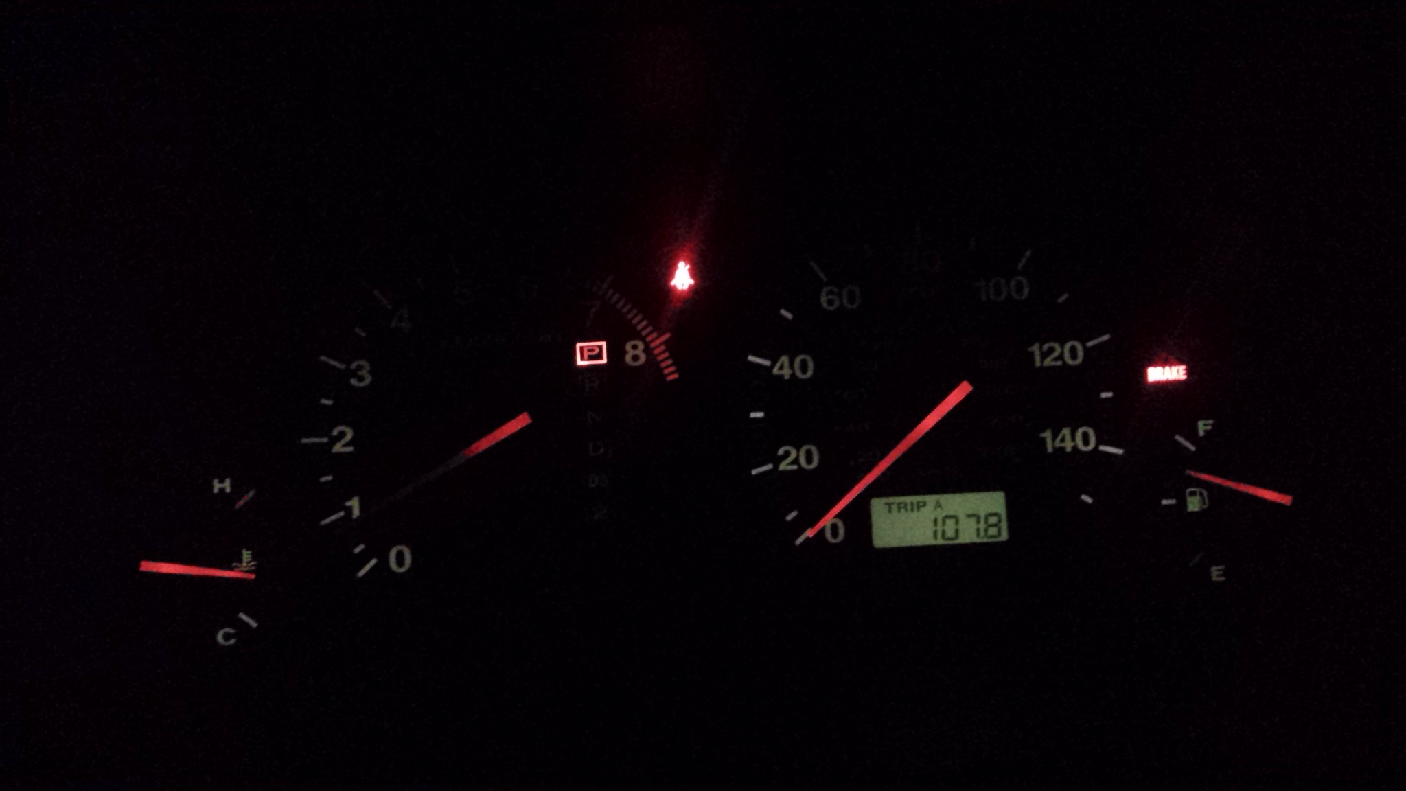

Bought a used 2001 civic lx. Gauges don't seem to light up all the way
Old Apr 20, 2015
bo_red's Avatar
Joined: Apr 2015
Posts: 41
bo_red will become famous soon enough
Here's a picture of the display panel
See how the top part isn't lit? What's the problem with this? Some electrical short?
Last night was the first time I drove it at night and then I noticed it.'
Any insights will be helpful
Looks like it needs some light bulbs replaced.
Pull the cluster out and you should see several bulb sockets to twist out.

When I was at the honda dealer to order the parts for national recall frepairs, the guy there mention that there was another recall about some electrical problems
Probably the one for the low beam headlights.
Do you think maybe this is related to that? Or is it common for these bulbs to go out like they have?
Unrelated.
Incandescent light bulbs go out and need replaced.
Take a look at the back of the cluster, it should have a pile of places for light bulbs
Random parts diagram, looks like 11 bulbs might go in the area outlined by #1 (some are for illumination, some are for warning and indicator lights):

Re: Bought a used 2001 civic lx. Gauges don't seem to light up all the way
Unrelated.
Thank you I'll see if I can do this, if not, I'll have to ask someone at a shop.
