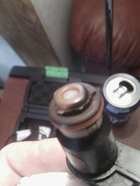

Yes determined with multimeter, that injector is bad, however
I noticed at the bottom of the injector where the little ports are, the
small plastic part around the bottom was missing like half, real small
pieces of that plastic not there, assume the pieces are in the fuel
injector port, down in there, and wondering is that a problem? Can
that cause issues? THANKS!!
Old Mar 24, 2015
Rep Power: 518
Re: 2004 civic 1.7L lost one cylinder?
however
Got a picture you can post?
Here is a pic I think (tried to upload)

Man, I don't have any injectors laying around here to look at.
Does it come with a new injector?
U-pull yard, grab a whole set with the rail and all?
If you look at that pick, at the very end its missing a real little piece
of plastic around it there, I guess it cracked and the pieces fell off
Im assuming in the port where I got it out from. Just wondering if
those little pieces would damage anything if it fell down the injector port?
Old Mar 25, 2015
Rep Power: 518
As long as it wasn't steel, I expect it would get chewed up and spit out without incident IMO.
Yeah it was plastic
THANKS AGAIN
(I switched to just confirm, and for sure it was the injector bad)
Wheeeew life saver....
