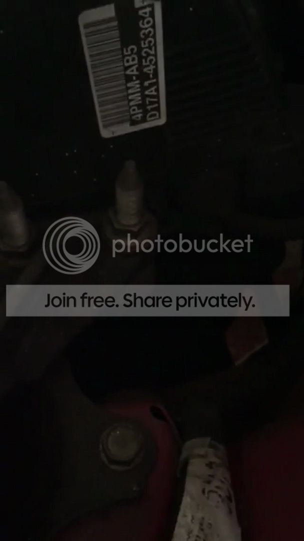

I have a d17a1 and I've been hearing a tapping noise coming from the engine compartment for 2 weeks now. I thought it was a loose exhaust manifold shroud, that's what it sounded like when it loosened up last year . Yesterday when i was a mile from home, the check engine light came on and had trouble accelerating. I hooked up the code reader and only got a p0344 (Camshaft Position Sensor A Circuit Intermittent Bank 1 or Single Sensor). Does it sound like the valves are toast or can i get away with replacing the sensor and timing belt? I've never had a belt go out on me and don't know how it sounds.
Here's a video of the sound
http://vid1379.photobucket.com/album...psn1ealocj.mp4
https://www.flickr.com/photos/103220...57650921372200

Weird, it's working fine for me I added a Flikr link, maybe that one will work
