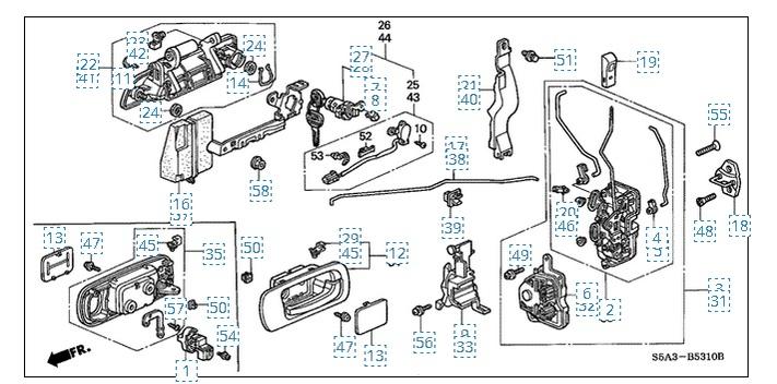

My wife's civic has a problem where the lock will not turn at all with a key in it on the driver's side (there's no keyless entry), and the power lock button won't lock the front door either. She uses the passenger door to get in and lock the driver's side. The power lock button locks the other 3 doors just fine.
I did do a search, but I'm not super-mechanically inclined, so I'm not sure if what I'm describing sounds more like an actuator or cylinder issue. I'm am super-poor right now though, so I will try to fix it myself, but don't want to buy an actuator if I need something else.

Can you manually pull and push down the sliding lock actuator? Put your ear to the door. Plug one ear. Do you here the power actuator thumping as loud as the other doors? Here is your door. I have replace the lock actuator on 3 of my 2005 CRV doors. The small screws were loctited in and you had to reach back in a small opening after you took door panel off. Then it was a lot of wiggle and position of the rod all back in there working with a mirror. Real pain. I've been working on cars for years and have a garage full of tools. However, you could pull the door panel and see if one of the rods plastic ends is broken. You really need to fix this. It is illegal and dangerous to drive a car when a front door will not open. Accidents do happen and fires and all sorts of bad things. Remote but you would have to live with it if it happened. I sure would not let anyone drive it like this.
http://www.collegehillshondaparts.co...oor-locks-scat
Sounds like it may need a cylinder rebuild or replace. Any dealership should be able to retumble a new sidewinder lock so your original keys can be used.
In my town, the dealer is the only place that can do it. Local lock shops don't have tumblers for Hondas sidewinder locks.
Listen first as per the previous reply.
If you can't hear or feel any power action at all inside the door, then pull the door panel off and TEST for power/ground at the lock actuator 2-wire connector. A simple 12v, #194 light bulb can be used to test.
Bad actuator is common, but every once in a while it's deeper than that.
