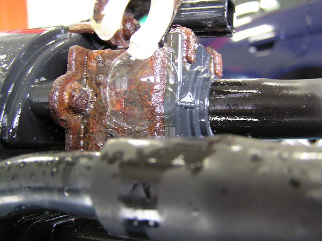

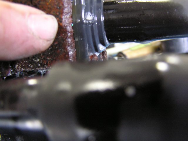

First I use my scanner to activate each solenoid and listen for the CLICK.
The typical failure I commonly see is the CVS valve bad or leaking, but there are other possible causes. Chasing EVAP codes can be a hair pulling experience.
Here's a pic of something that is becoming more common as the cars rust to death: CVS valve rusting apart and leaking externally:
These were taken after the canister was removed from the car and pressurized with about 1 PSI, and I sprayed soapy water on the whole thing so the leak would bubble.
You can see how rusty it is, there's almost nothing left of the screws that hold it to the canister. If the screws can't break loose, the canister will need to be replaced too.

I have replaced my downstream o2 sensor with the OEM NTK sensor $60. I drove my car for 120 miles since the replacement of the sensor, at about 40 miles the CEL light came back on. I had the code run after 120 miles, it was the p1457 code. Hopefully the other two codes wont come back now that the o2 sensors fixed. I guess I should start with the CVS vavle.
Old Feb 11, 2015
Tylerb3625's Avatar
Joined: Oct 2012
Posts: 7
Tylerb3625 is an unknown quantity at this point
Re: CEL, is it the o2/ air fuel sensor? 2005 civic Ex
I took the evap canister off today and when I went to unscrew the screws that hold on the canister shut valve, the thread inserts came out with the screws, looks like I should jb weld them in place Once I get the new valve?
After getting the canister shut valve off of the canister I pressurized it and it was leaking out the side, I ordered a new one it will be here tomorow. hope it was the only thing leaking.

Ya, that's exactly what happens. The screws seize and try to pull the inserts out (or they just spin).
This is the point where I estimate a new canister along with the CVS valve.
You can try epoxy if you wish, will save a few $$ if it works.
May want to apply antiseize to the threads of the screws as you assemble it too.

Figured I would give an update on the cause of the problem. I fixed the evap leak, it ended up being the Canister shut valve. Since the thread inserts pulled out of my canister I just re-tapped them to 5/16-18, then drilled out the holes for the new canister shut valve. Between that and the new o2 sensor, my CEL light has be off for 150 miles and I passed my echeck. Thanks for every ones help, it saved me a lot of money!!!!!
