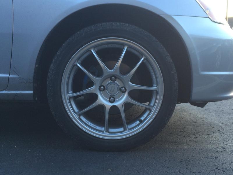

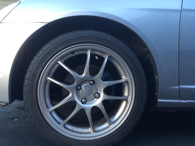

I'm not sure about wheel lean yet, I'll try to check that this weekend. I checked the approximate clearance of both wheels with my fingers and took pictures. The front right wheel has about a half inch more clearance at the top than the left. The front right wheel is also a bit further back by around a quarter to a half I'd say (the left is about even left and right).[/QUOTE]
Originally Posted by ezone
Inboard edge wear could be caused by excessive negative camber, or negative toe, or both.
A wide tire can show wear from these quicker than a skinny tire.
I looked the tires over this afternoon a bit and it seems that both edges the fronts are wearing away but the inner edge of the right front is wearing away more. By the way, I usually run 30-35 pounds of pressure in all tires.
Attached are pictures of front right tread wear, front right tire, and front left tire.

Slight knocking when going over bumps (sounds like front right). I think one or more of the control arm bushings are showing significant age (dealer recommended so I didn't just take their word for it).
That tire tread looks an awful lot like the Michelins I put on my car. 225-40-18 Michelin Pilot Sport A/S Plus
Mine at 10k miles are starting to wear the inboard edges on all 4. Minor at this point, but it's a little disappointing.
Does the car lean? Was it sitting on flat level ground at the time?
Half a finger width? If the fender hasn't been 'repositioned' by accident damage, that might indicate a possible low caster issue. Hard to say without seeing it firsthand and checking out the actual alignment numbers.

The car doesn't lean as far as I can tell and it was on pretty flat ground. I'll look that lower arm over this weekend hopefully and really check the bushings too. If/when I replace that arm (or both) would you recommend oem or Napa or...? I'm alright spending for Honda parts if you think they are worth it in this instance. Same question for if I replace knuckles and struts. Would you recommend the Honda ones? I only ask because I've never replaced knuckles or control arms before. And yes, those michelins, and the last pair I had, have been disappointing.
