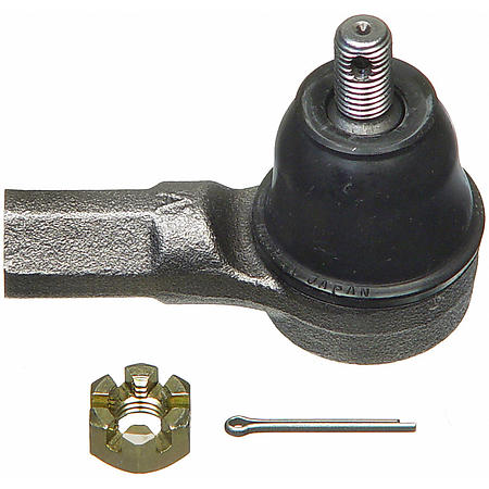

Now i have a new Question...
I bought these - http://shop.advanceautoparts.com/p/m...581/20515912-P
It doesn't have a (screw) hole on top to fill grease... it has a (very) thin hole at the other end though... As far as i know, i have to fill grease before i put them... How do i go with these now ?
Help appreciated... Thanks
Old Oct 18, 2014
Re: Stuck Outer Tie Rod!!!!!
I don't see the name MOOG on here. Counterfeit?
The description says it's greaseable, yet no place for a zerk to thread in. Counterfeit?
True MOOG parts should say MOOG right on them IIRC.
Made in Japan?
Reboxed OEM?
Move the rubber boot to the side, see if it's already greased.

it looks almost empty...
Look at the tiny hole on top... does that mean something ?

The boot doesn't need to be full, but the body of the joint should be.
Take it back, throw it on the counter, say WTF?
Go with OEM?
Install these anyway, see how long they last? (Load with chassis grease first and work it in)

also... one strange thing i noticed... the original look similar too...but one small difference is that they don't that "tiny hole" either... Wonder how they even filled grease into them... :-/

Hmmm. Not sure what to think here.
Checked the MOOG (Federal-Mogul) site: http://www.fme-cat.com/overlays/part-detail.aspx?brand=MC&PartNumber=ES3581&pt=Tie%20Ro d%20End&lu=2003%20HONDA%20CIVIC&vin=
Old Oct 18, 2014
If the 'made in Japan' unit has a nylon impregnated bushing (same as OEM) instead of the powdered steel of the MOOG problem solver unit, I think I'd rather use it.

so u mean, not filling any Grease at all ?
OE is lubed as it is built, and then completely sealed.
Old Oct 18, 2014
I'd still squirt some chassis grease into it and move the stud around to work the grease in.

Changed them to a drive works tie rods & finished off the work
