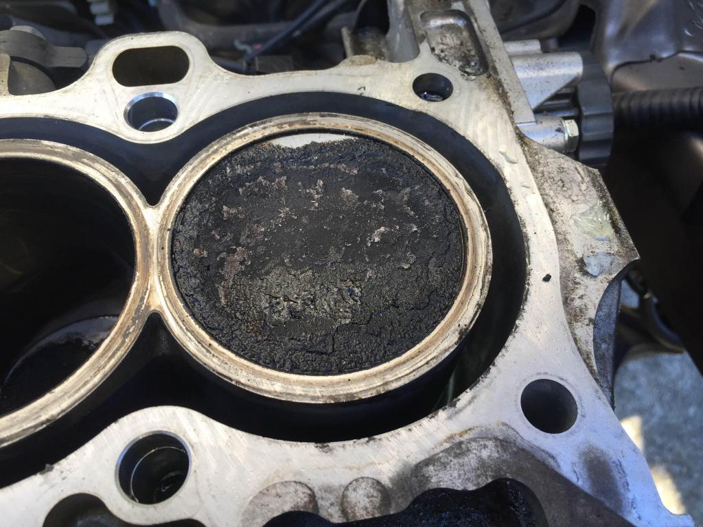

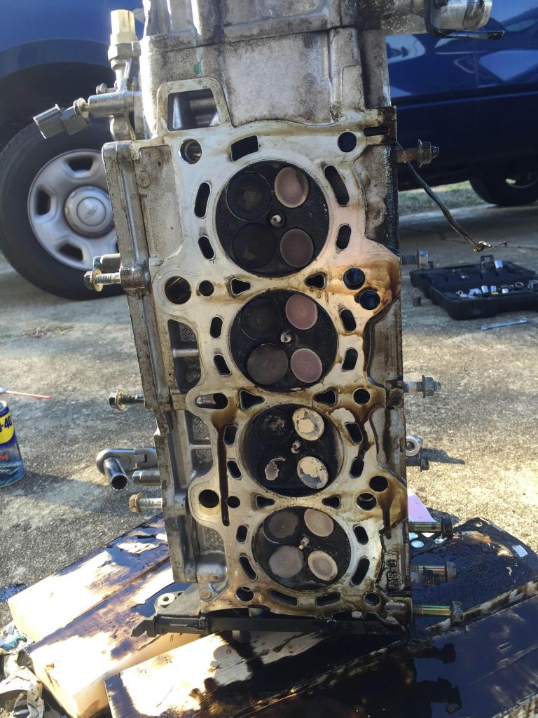

so finally got around to working on this turd and got the head off. I was pretty amazed how much gunk builds inside the engine. I figured it burn off most of that stuff from the high temps of the engine but I guess not. Here's what the valves look like, the second one from the bottom are the valves for the cylinder with significant compression loss. I was expecting to see a crack or something in the valve like I have when I google searched burnt valve but I can't see anything. I would assume there's still something wrong given the coloration of the valves compared to the other ones.

The top of the pistons are pretty gunked up as well. So I'm sure it'll take some time to get some of these layers off.

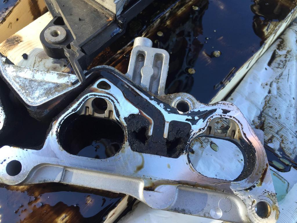

I left the air intake on it when I took it off the engine and then removed it once I had it out. When I took it off, the plastic part comes out, and then there's a metal piece that goes between the head and the plastic piece (injector base according to the majestic honda diagram). There was a considerable amount of gunk on the head at the air intakes seen here:

And the injector base was really gunked up!!

Wtf is all that and how does it get back in there? I'm assuming all that needs to be cleaned and scrubbed good before being reassembled correct? That's not some kind of grease that just happened to change colors?

That's carbon buildup.
The pics of the head look average and I can certainly tell which one had the problem.
Piston is average. Carbon will build up so far then sustain more or less, it reaches a point of self cleaning. The piston on the cylinder that had the problem may have more buildup.
The intake ports and the manifold plate: remove the plate with all the carbon in the passages, take it off the manifold and clean it thoroughly. That is the EGR distribution plate and it DOES build up a lot of carbon. The goo in the intake ports is just more of the same, the machine shop will probably have that gone when they clean the head prior to fixing the valves.
