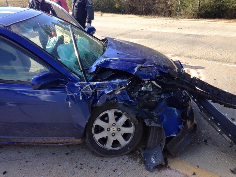

Dont have to worry about my overheating issue anymoreName:  10888546_10205535337599807_4772277653089712653_n_zps6ddf2df9.jpg

Re: Overheating issue
HOLY CARP!!!
I hope everyone is OK

Originally Posted by ezone
HOLY CARP!!!
Yeah. Cop said it is most likely totaled. Oil and coolant was everywhere. We are just beat up with muscle relaxers and pain killers to satisfy us. The other driver was very professional about it making sure we were still okay 6 hours later after we all left hospital. Probably gonna go to chiropractor tomorrow cause my back already isn't that great and this didn't make it better. And I'm only 19 so probably can't get a rental car. Good thing I have a lot of friends already offering to give me rides for the next couple weeks. But I hate to see this happen to my car. First car wreck(motorcyxle wreck earlier in 2014 but wasn't as sore then as I am now).

Man, that looks like a total to me. Glad everyone is alive!

Def a total.
A few years ago I popped a curb at maybe 25-30 km/h and did $3500 damage, with used parts! Control arm, sub frame, sway bar, not to mention all the SRS components like the seatbelts and new SRS module which I got new from Honda. That damage has got to be more than the cost of that car.
Glad you are o.k. At least now you know more about a Civic so you can make a really imformed decision about your next one!

If battery didnt break off then I bet it for sure overheats now. Lost oil and coolant

I mean technically you can fix it...new engine and tranny, fender, hood, battery, axle(s), subframe, control arm, airbags, buckle and belt tensioners, airbags, SRS module, brake assembely, windshield and a bunch of other small stuff. Definately not worth it. Get the insurance claim, take a deep breath and move on to the next one... it happens...

ouch! from the look behind the front fender, most likely bent frame. Total, sad to say.
glad you mostly ok.
