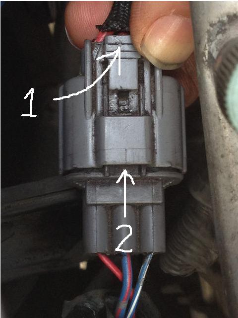

I'd like to test the thermal protector.
I'm trying to do this before/without taking the
alternator &c apart, so what I think I want to
do is pull the connector apart & test continuity
or jump across it. But I can't get that connector
apart. How do you do it? It's an S-973 I think.
https://www.flickr.com/photos/32292837@N06/15345945815/

Re: 2002 EX AC problems
Squeeze that button under your thumb (#1), and pull the connector halves apart.
If the button has been damaged, you may be able to slide a pick or tiny screwdriver up in the housing to release the lock (hidden in area #2).
