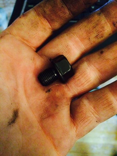

ok in going back over everything I found this bolt. In looking at spark it doesn't seem strong. Whirling it over with the plug on the coil there isn't spark right away after a second or so. It seems to try and start but will not fire up. I haven't readjusted the valves. I can't see any tdc mark on the crank pulley? I thought there was supposed to be? In reading threads does this dx actually have immobilizer system I didn't think so. Am I wrong? Thanks.
THAT looks important.

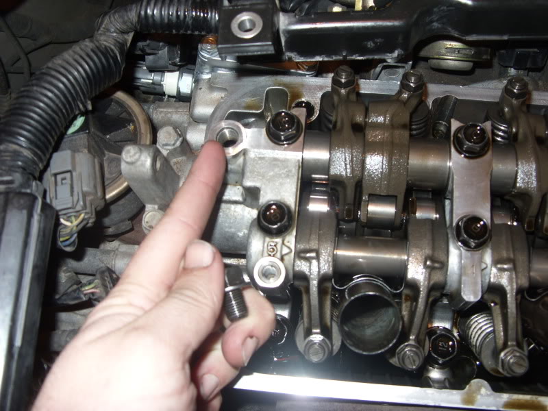

See if it matches this one:
