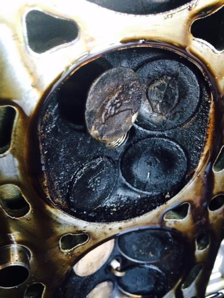

pic here ya go.

The intake manifold bolts are a real B***. I'm just taking a break.
19 Minutes Ago
pic here ya go.
That didn't take long at all! LOL
Hey, you got a valve stuck wide open. If you were tapping on it when the keeper popped out and got lost, that makes me wonder if the valve contacted the piston and got bent?
That chamber is full of soot and carbon like it's been suffering from low compression and poor combustion for a while.

Ya the previous owner said it had been missing for a while. As for te valve out, that was just the picture. It did seem bent but I don't know. Because it would not slide in and out easily. I thought I'd put it back together with PAP head parts but 1.6 has same valve size but not length. They have the same keepers so I assumed they were. NOT. I guess I will be ordering now.
