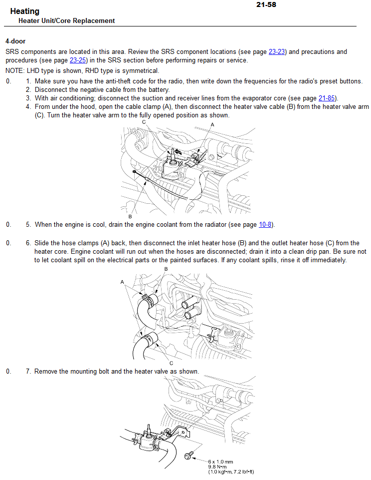

Can someone please post a picture of the heater core hoses. So i can bypass them. I really need this.

Re: Pic Request- Heater Core Hoses
