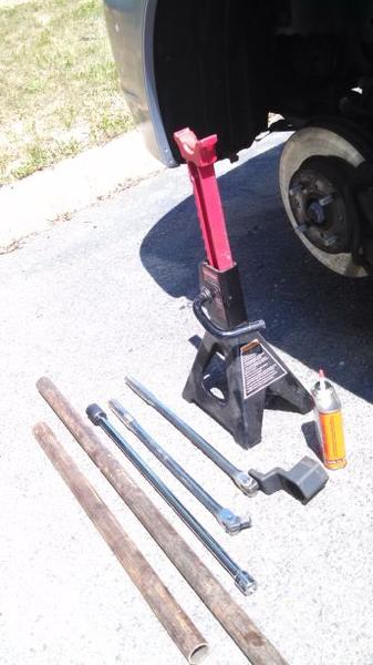

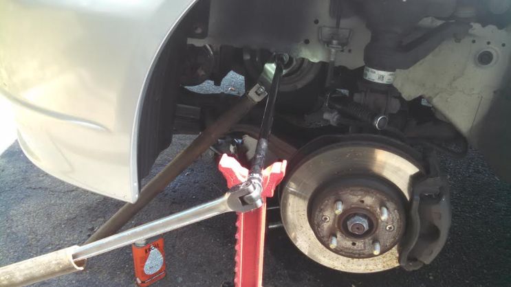

Just wanted to follow up, if anyone is stuck at the crankshaft bolt here's what I finally went with, and it just about jumped off of there - putting it all back together I used 182 foot pounds on a torque wrench and it seemed like just about nothing. Not sure if wear and tear just welds these things on there, or what.. As for the timing snafu, I guess nothing got bumped out of whack 'cause she's good to go.
Name:	Breaking the Civic Crankshaft Lockbolt.jpg
ID:	86888   Click image for larger version
Name:	This is what you need to break the Civic Crankshaft Locknut..jpg

yeah thats pretty much how i do my crank bolt too,
tightening it up i dont even use a torque wrench, i basically do it as tight as i possibly can with an 18 inch breaker bar, i guess i would compare it to tightening up a wheel stud with steel rims, seems to be fine
