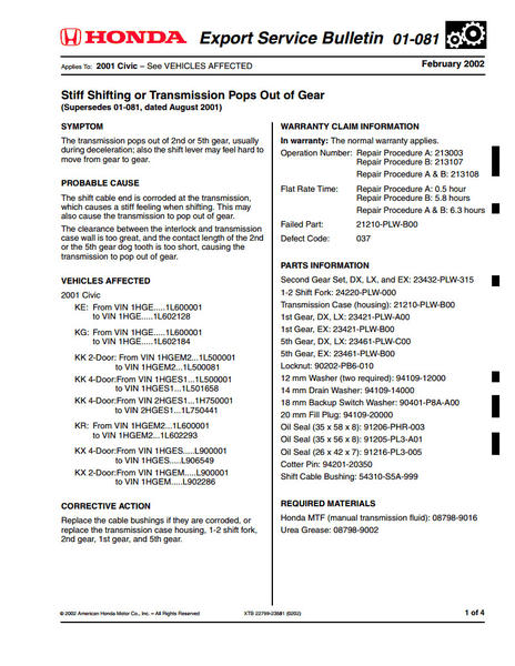

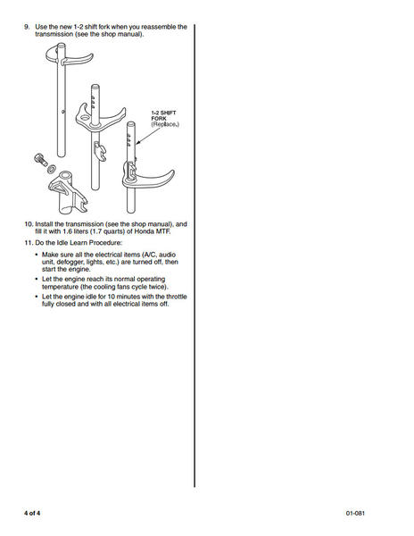

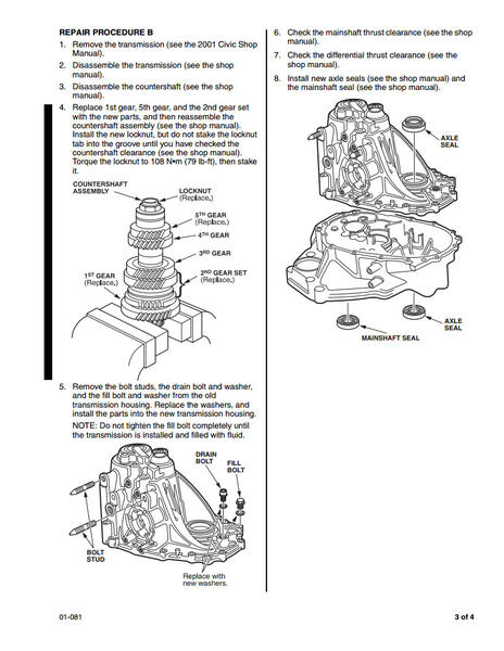

*Also, I found an old TSB (01-081 Feb 2002) about the transmission popping out of gear, it seems much like my issue. But with the age and mileage of the car I know it would be a waste to contact a dealer about it, there is a lot of parts involved in the fix and I don't know if the car is worth putting that much money into it.

For laughs, have you tried replacing the trans fluid?
Probably 2 quarts of Hondas MTF
