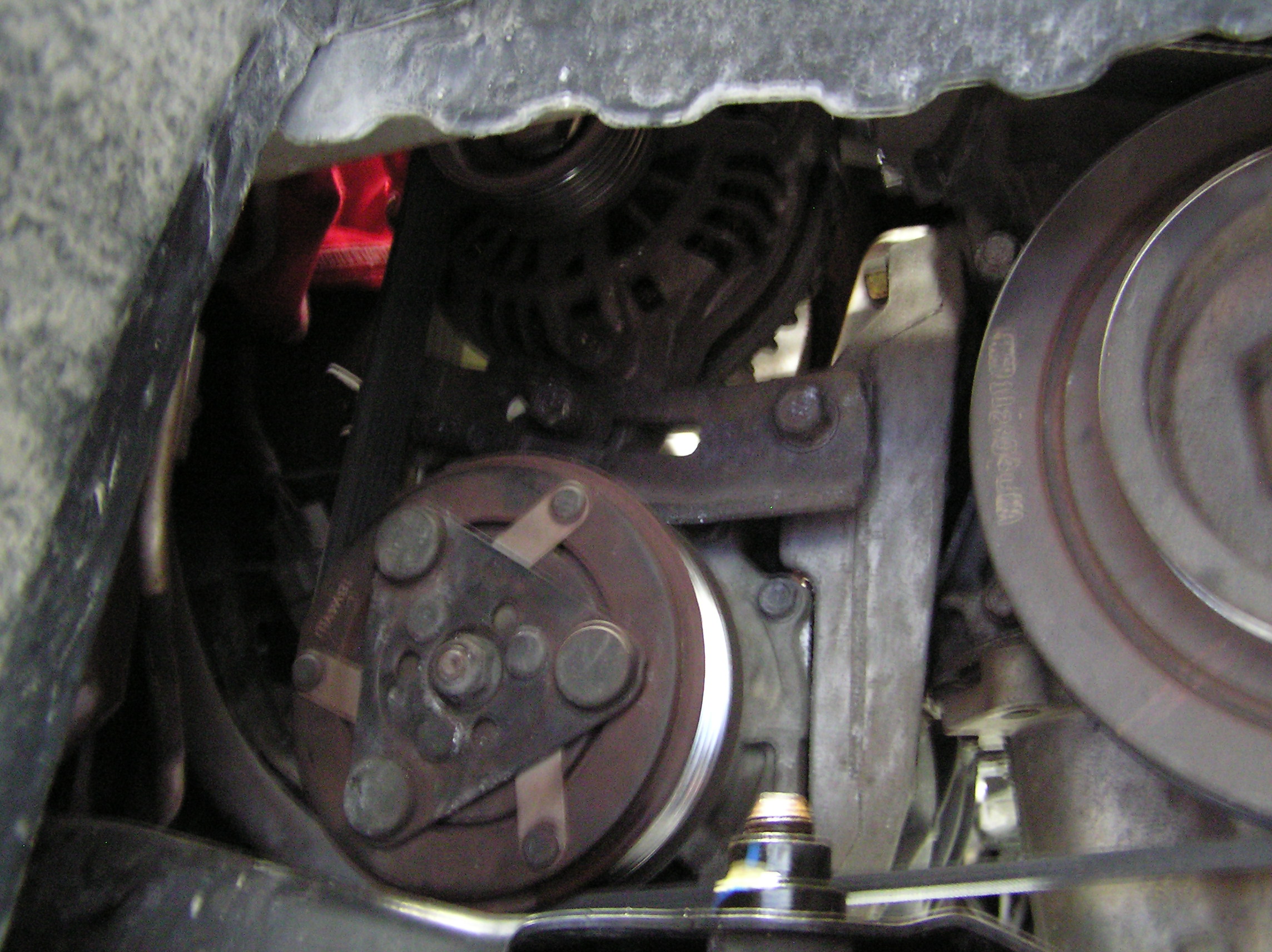

I don't know how many bolts the alternator has so I am unsure which bolts are loose or missing, or where I should look and how I should fix the problem
There's one bolt with a 14mm head you get from above, it's just under the PS pump.
Then you go through the wheelwell to find the others on the adjustment bracket.

To get to the one from above I will have to remove the pump right? I am a little afraid hesitant because those hoses look important lol. Also, there should be a total of 3 bolts right?
