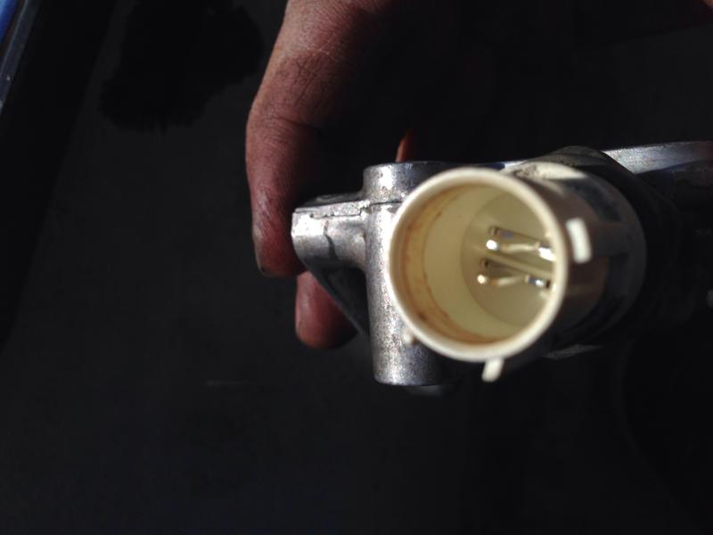

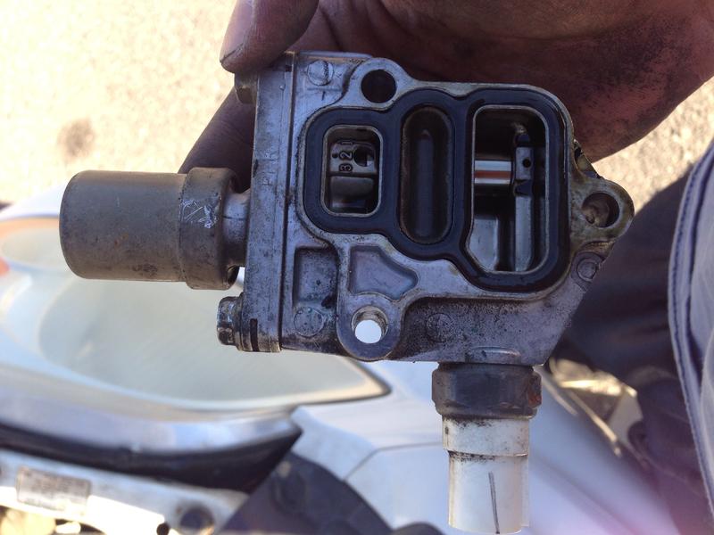

Well, i may have a leak somewhere, i just do not have gas to start my car to check if the oil is low, but i am going to do that, so in the meantime I checked out my vtec solenoid, everything looked to be fine. My oil switch didn't look to be damaged or dirty. The hydraulic in the solenoid valve didn't have much debri, with just a little bit of gunk, so i cleaned it out. I have pictures. The picture doesn't show, but i cleaned out the filter haha. I was just in too much of a rush to take a pic after i cleaned it with a cloth
ID:	86320   Click image for larger version
Old Jan 26, 2014
Re: Hesitation & struggles up hill !
You check engine oil with the engine OFF. Same goes for automatic trans fluid in Hondas.
That's no way to evaluate an electrical part. You gotta figure out if it operates correctly or not.
Have you cleared the codes and driven it to see what code(s) return?
Gotta establish whether or not the code is a consistent fault.
If the VTEC code you want to chase is intermittent, you may have a hard time finding a real fault.
As far as testing the VTEC solenoid and switch, my first choice is a proper scanner to see what's happening and what the computer sees.
Then I'd probably use active testing, meaning manually make it operate and check for actual activation and response. Jumper wires, a voltmeter, and maybe a test light.
