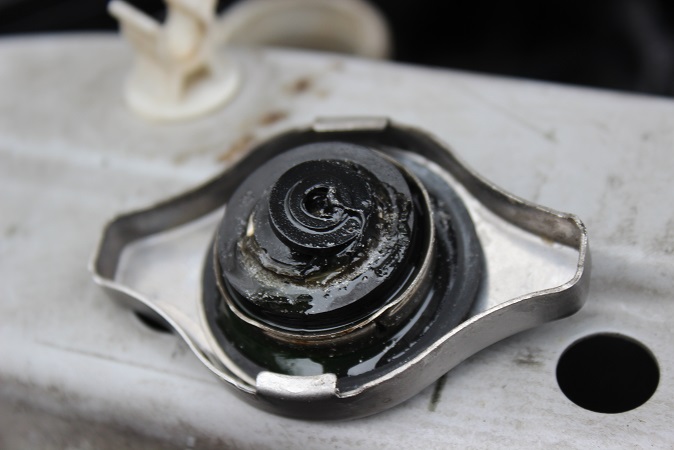

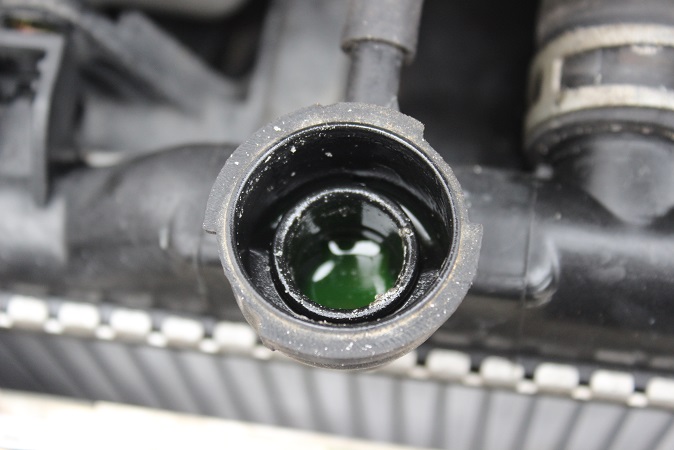

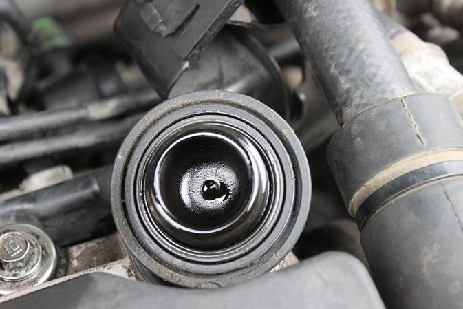

Ok I snapped some pics, it had been sitting for about 30 minutes

Cap looks bad, replace that right away. Probably almost any parts store should have one.
Neck of the radiator doesn't look like it's damaged in the pic.
I don't see enough junk in the neck to be a concern, wipe out the flakes of whatever the residue is and fill it to the top with coolant.
Install new cap.
Make sure the overflow bottle is filled to the MAX line too.
You can use any old lid to cover it until you can get a correct part. (Cap might be laying somewhere, trapped where it couldn't be seen when it got dropped)
Overflow reservoir cap is part # 19109-PH1-620, about $6 at a dealer
