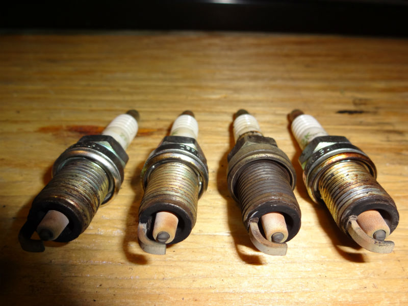

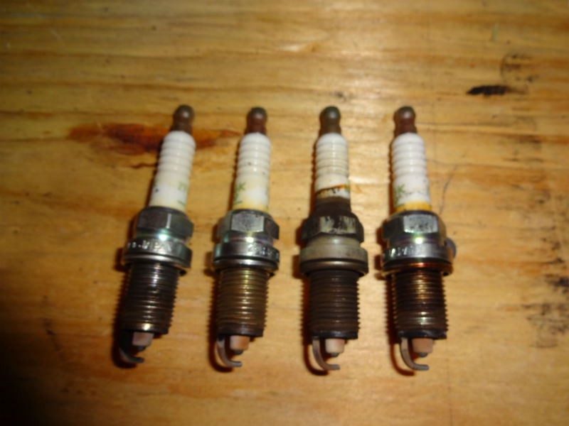

Here's an example from an older post of what I was talking about:
Plugs look fairly normal ---- with an exception.
The one coated in black carbon was loose. #2?
The gasket was never flattened, it did not have a good seal against the combustion chamber.
Leakage comes up through the threads, leaving carbon deposits in the threads and on top of the plug and on the wire end, and in the sparkplug tube in the head.
A loose plug can overheat, and cause preignition ping/knock/detonation. A loose plug can't properly shed its heat through the threaded area into the surrounding head material.
I'd be surprised if the plug was not difficult to remove due to threads binding (known as "carbon lock").
Kinda looks like the others weren't fully tightened either, judging by the look of the gaskets.
Were they super easy to break loose? Little or no resistance? Felt like you didn't even need the ratchet for the initial pop?

The three I was able to get out looked much like the three in this pic.
