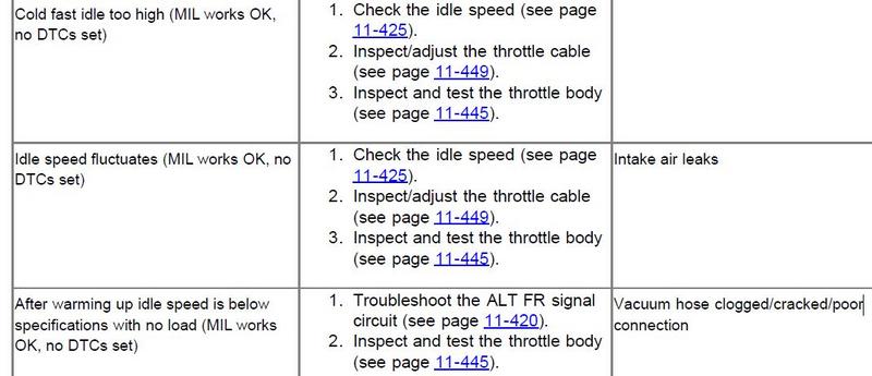

The only time I saw something like that is when my 90 Honda accord fast idle valve was bad.
How's is your coolant? Did you try unplugging the IACV connector and see what happens.
See attachment for other troubleshooting. You can download the service manual as well.
Idle Control System Diagram
The idle speed of the engine is controlled by the Idle Air Control (IAC) valve:
After the engine starts, the IAC valve opens for a certain amount of time.
The amount of air is increased to raise the idle speed.
When the engine coolant temperature is low, the IAC valve is opened to obtain the proper fast idle speed. The amount of bypassed air is thus controlled in relation to engine coolant temperature.
