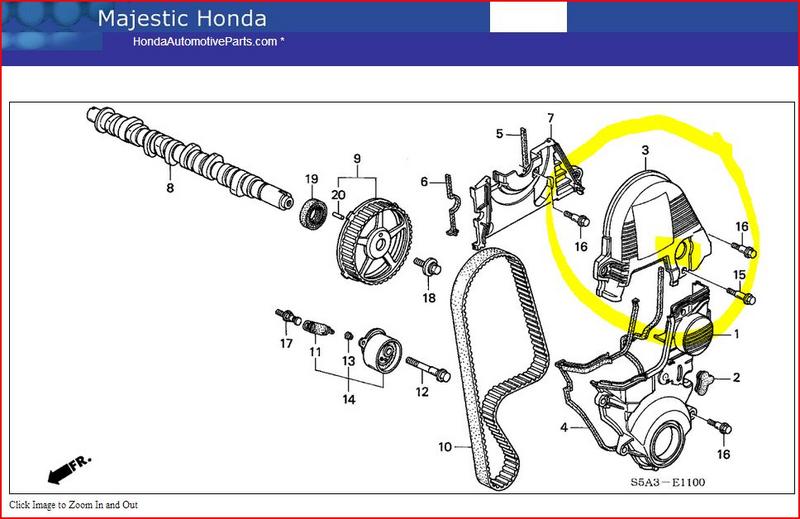

This happened to me a few years back. The service manual on Page 11-8 calls this code out as your Top Dead Center Sensor. There are some diagnostics you can do but basically they will just tell you that you either have a bad wire, bad ecu, or bad sensor. IMO it is most likely the 3rd.
If I remember right, the sensor costs about $60-70. You would have to pull the valve cover to remove the top timing cover. After that it is one bolt and you're back in business. I've highlighted the top timing cover on this pic and also the sensor location. The sensor is not shown in the pic but is on the list page for "Cylinder Head" item 10.

Just adding to JJ's post with the picture of the sensor, piece #10
Looks to cost $42.90 plus shipping from majestic honda.
