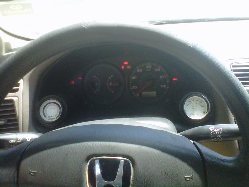

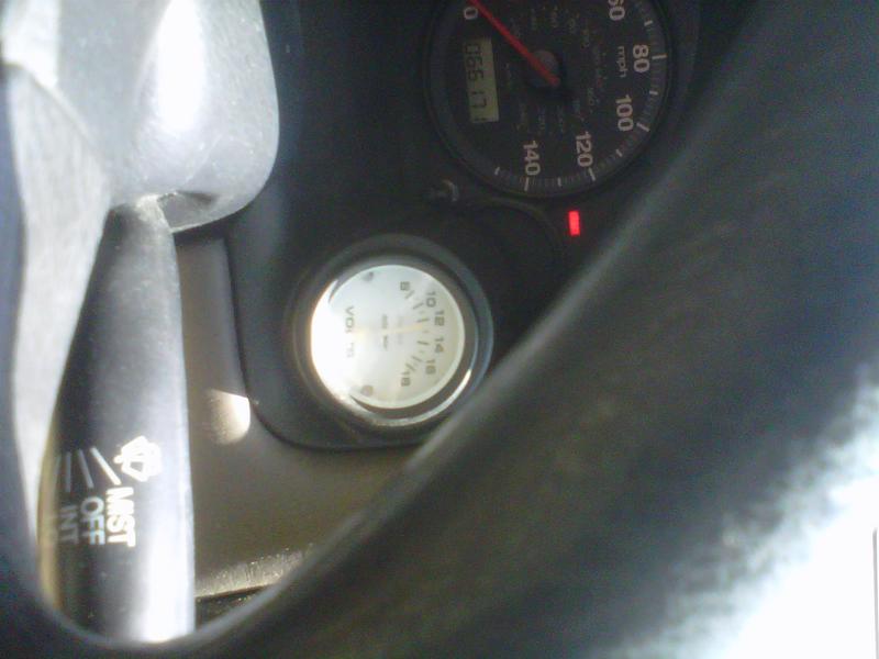

7th gen dont have volt gauges but if thats what you were getting on a volt meter then thats normal

I attached some photos to show what I'm talking about.
That particular meter's needle, usually floats above 12 to around 14. After trying to crank it enough times, if I attempt to turn the key over to start the car, it jumps down to about 11.
Pointing out that if it does have some significance in relation to whatever the output of the alternator might be, I've never seen the gauge read anything higher than 14. I've seen lower, because say I left a light on in my car on accident and the battery almost died, but never too much voltage.
I reattached my air filter (was gonna clean it since I'm doing everything else, decided not to), alternator (made sure it was good and tight this time), and I managed to reinstall the belts and made sure my tensioners were as tight as I could possibly make them (also secured the P/S again).
I checked to see if it would magically come on, it would not :P but this did give me the chance to see if my spark plugs were wet like ezone suggested.

slightly relevant: One of my classmates happens to live in my complex, saw me working on my car and came to say hello. Apparently he works at the local autozone, was asking me about my car, told me it probably wasn't the PCM, but rather my starter or my ignition switch. Apparently said gauge on my dash and some sort of regulator the car should have would help prevent the alternator from putting out too much voltage. switches go bad all the time on the civvy's apparently.
Told me to disconnect part of my starter and tap the positive end of my battery with it, to see if it turns on/works. I didn't do this, and I don't really know the validity of his thoughts, but I figured they were worth mentioning on here.
ID:	84918   Click image for larger version
ID:	84919   Click image for larger version
Last edited by Breedwell; Mar 29, 2013 at 02:44 PM. Reason: forgot to attach the pics :P

[YOUTUBE]http://www.youtube.com/watch?v=O_T8GUuppbg[/YOUTUBE]
my "it shoots up" was referring to the volt gauge thing.
gonna have my girlfriend try to start the car while I tap the starter. See if that works tomorrow.
