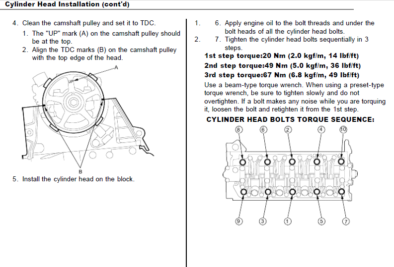

the head bolts need to be torqued gradually and evenly in a specific pattern until you reach the final torque spec, not sure off hand what that is, dont have my manual with me,
you should be torquing them gradually though, like all of them to 5 foot pounds, then all of them to 10 foot pounds etc etc,

i guess what am i asking is can i go over the recommended setting of 49, thinking maybe add 2 more lbs and maybe it will fix the issue.

no i dont think that will help,
you will be risking stripping the bolts and/or crushing the gasket,
did you torque them gradually in the pattern?

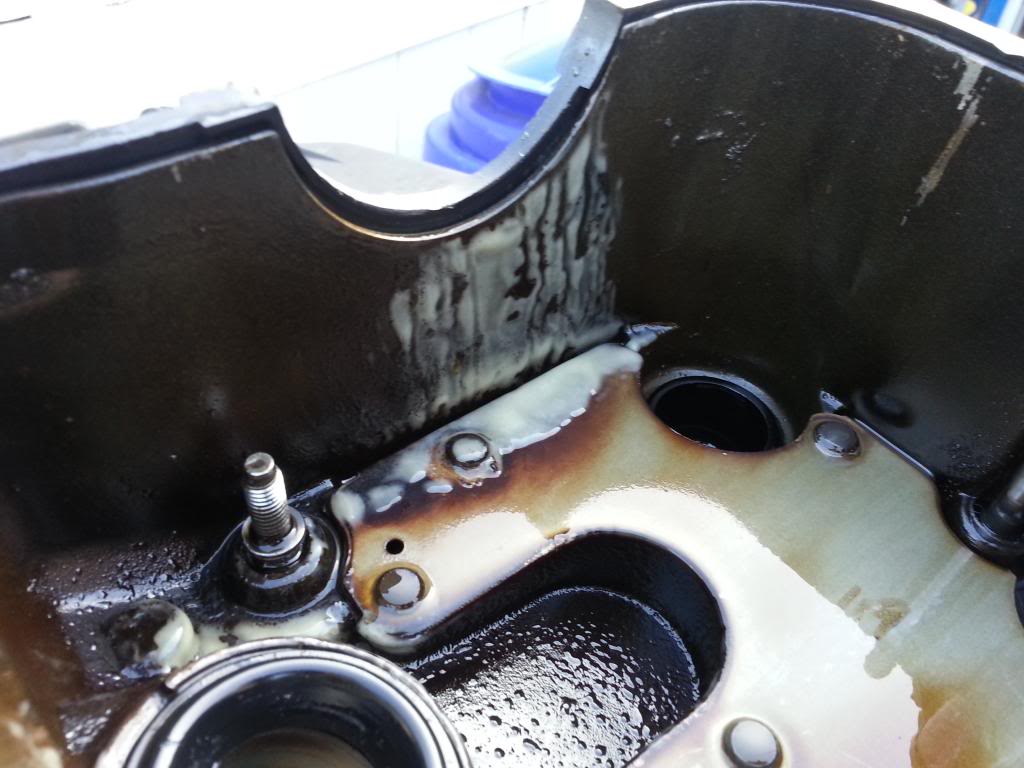

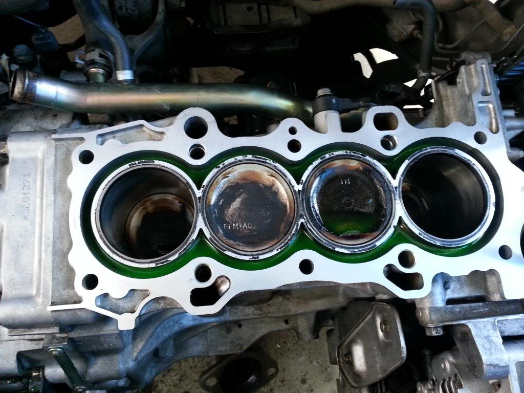

i went by the book, from a-z. so yes i torqued them correctly. i pulled the head this afternoon. found some milky residue in the valve cover. so the guys on the d-series recommended going 100% oem headgasket, and this should fix the issue. also couldnt find signs of failure with the used / new gasket only 200 miles on it.
