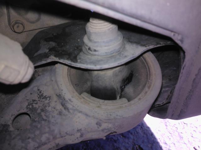

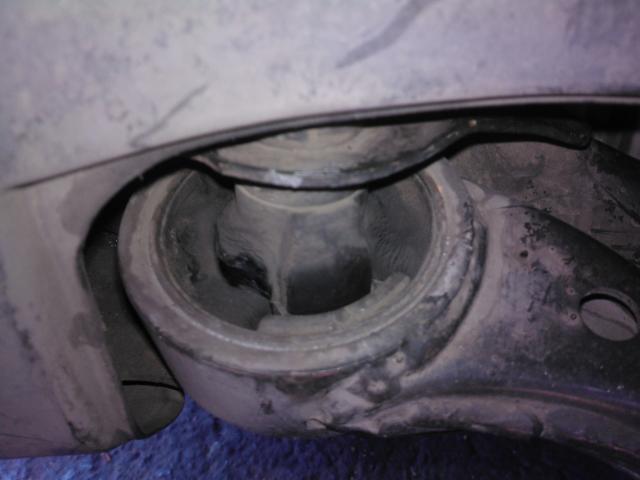

So stabilizer links seem solid, but.....I did find this. These were replaced once already in '07. I guess it's more of a thunk than a pop. I'm thinking the control arm is hitting the frame and that's the thunk I'm hearing over a speed bump.
Driver's side
Passenger side
I already called the dealership I would take it too. It's more cost effective parts and labor wise to let them press them out then it is for me to buy 2 lower control arms from majestic. I don't have access to a press.
They told me I should have a wheel alignment done, but I have the option not too. At $90 for the alignment, will these torn bushings effect the alignment that much? I'll spend the money, I just want to know if it's really necessary.

You should be able to push the arms up and down over those bushings and make contact with the subframe, yeah that would be a noise.
Crappy roads much?
The original struts always were a good candidate for being noisy too.
Yes on the alignment.
Yeah, I could pull the driver side up and make contact with the frame.

I just called the dealership again and ask them if they would install the bushings from the below link. They said they would. I'm thinking these won't rot away yet again in 5 years like these ones did. I'm always for OEM, but I think the below product is probably superior to the OEM bushings in this case.
