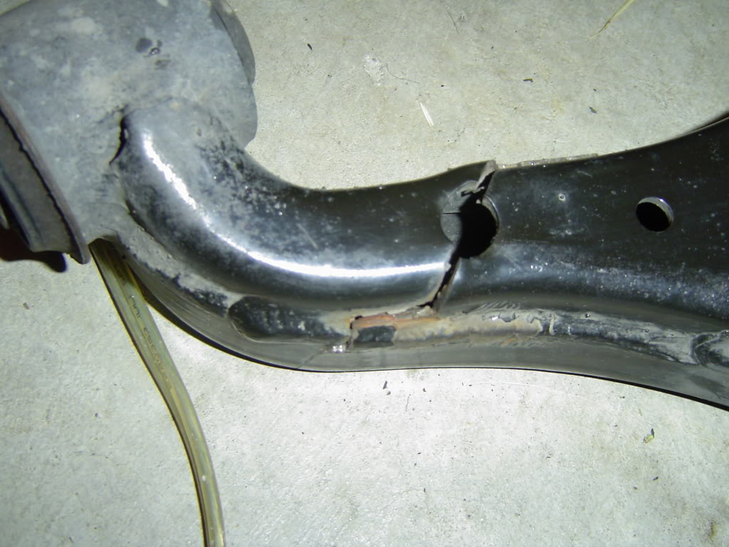

well, i never thought my LCA would ever crack without a real hard shock, but i had soem eventual "clanck" when going over some small expansion joints. nothing else was pointing to an issue.
this is what i found when i inspected more closely - this is in the upper side.
I am not saying it's definitely it, nor the subframe.
but i do think at this point a throughly inspection would be warranted...
I was surprised when i found the crack.
it could be anything at this point, considering all the issues you are having.
