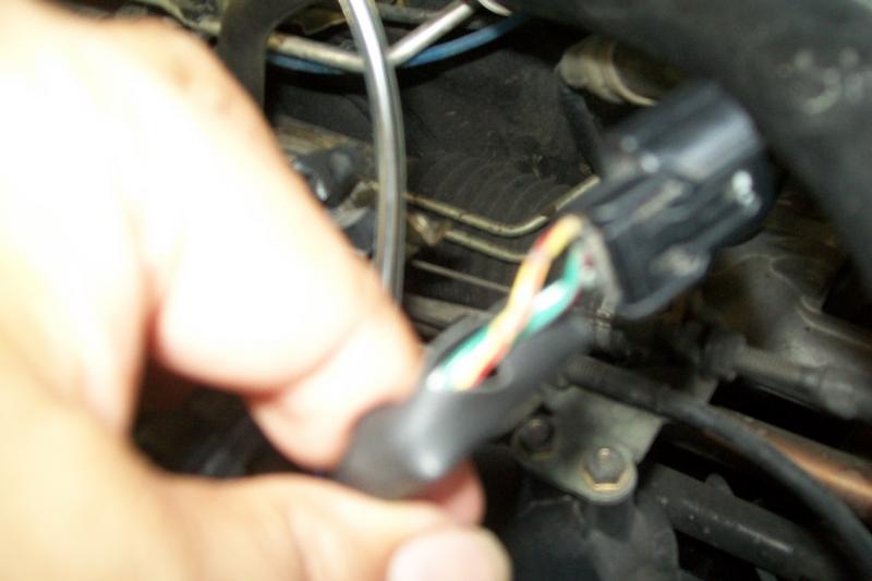

Attached is the pic for wiring to Map Sensor? To replace it, AdvanceAuto describes item as Map Sensor Harness for 685 Haywire Ignition System, is that what it is? I suggested it be replaced versus repaired? $ 35 cost.
What do you think?

I moved my post on HG elsewhere. sorry
