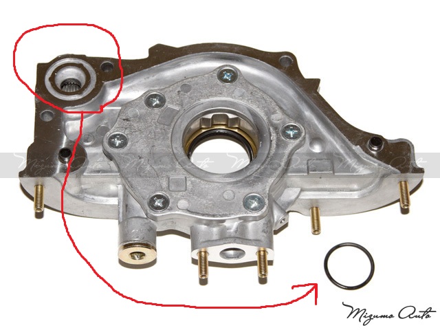

I sure hope it wasn't your internal oil pump o-ring leaking. I'd check it again in a week or so and see if you see any oil running out from where it would make you think it was the crank seal. There's about a 99.9% chance it's that internal oil pump o-ring if you see any leakage again, but hopefully it was just the crank seal.
I know about this because I went through this pain myself and ended up with double work for both the oil pan gasket and the crank seal, first thinking it was then crank seal and then thinking it was the oil pan gasket then finally determining that it was the internal o-ring on the oil pump.
I hope for your sake it was the crank seal.

Well, it would be a "pressure" leak in the sense that the o-ring I speak of is at the output of the oil pump where the orifice has closed down and has started to create pressure.
Link is for reference.
https://www.civicforums.com/forums/a...3&d=1335504804
