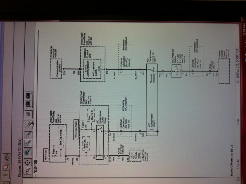

Thank you for the response. Sorry for the confusing write up. Just had a lot to say. I attached the diagram I used. It has Relay PIN 1 going to the thermal protector to compressor clutch to ground. After what you said, maybe I"m using the wrong diagram (2003 Civic Hatchback verse my Civic LX 4 door).
Based on my attachment you are saying the red wire on the pressure switch is going to the thermal switch on the clutch. So maybe I do have a bad thermal switch?
That looks like a partial diagram, and doesn't quite match the car you have, I assume (I'm using USA diagrams)
I have to assume your diagram is not correct, I am using factory info and it does not match yours. The thermal protector is not wired into the clutch circuit as yours shows.
It IS wired that way on an 01 car though.EDIT: I missed that in the 01 diagram.
Easy enough to figure out.
Is the thermal switch accessible easily?
I dunno, what is easy for you?
Its wires are in the clutch connector near the compressor.

I finally had time to look at the Ac issue. As I mentioned above the blue white wire from thermal switch and the red coming from the Pressure switch had no continuity. I finally had time to put in a new thermal switch and now those two wires have continuity. I"m happy that is fixed. But bad news is that the AC clutch still does not click on using the dashboard switches.
I looked further down the line. It's either bad Heater controller or push switch. I check the push switch using the self test and it worked. The LED still do not come on bright (very dim) but using a multimeter it functions properly.
As you mentioned above, Now that I jump A4 (blue wire) on connector A of heater controller with a jumper wire to A13 (black) ground and the AC clutch came on.

Your pic is sideways, I can't read it! LOL
Blue wire A4 (?) at the heater control panel: Ground it. If the AC works, then you have a problem within the area of the panel or its associated sensors (evap temp)...
Everything between the panel and the actual AC system is ok enough to run, the multiplex, the PCM, system pressure are ok.
The panel is likely bad. Figure out how to yank yours out quickly, then beg a friend with one that works to use theirs as a test.
