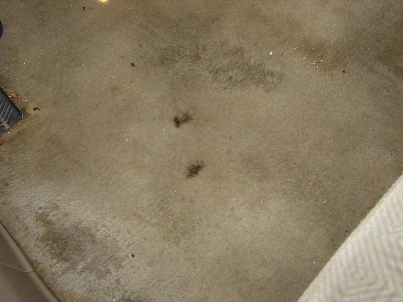

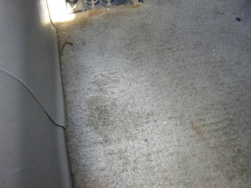

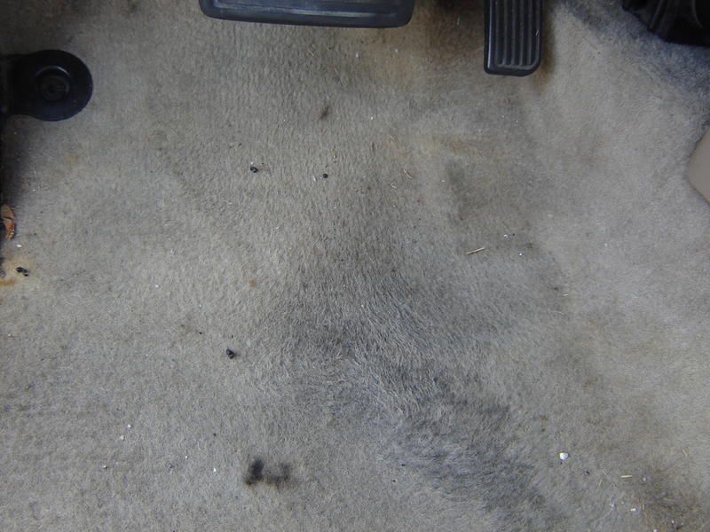

For the past 6 months, I've had a recurring problem with a wet floor on the driver's side of my 2001 Civic LX.
I've taken it to my mechanic, and he confirmed that the A/C drain line is clear, so that's not the cause.
A few weeks ago, I had to bring it back to him - again, no drain line issues, but he did tell me that he made an adjustment to the driver's side door - I believe he told me there was a 1/8 inch gap somewhere.

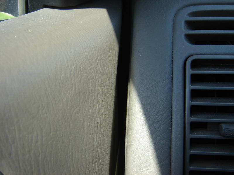

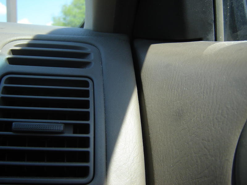

It rained hard the past few days, and I've got the same problem again - please see photos. Don't know if makes a difference, but I've also attached photos of each side where the door meets the interior.

It's raining hard again today, so this time I've set a bowl on the floor underneath the pedals.
Bowl is bone dry, but the carpet is getting wetter.

If it was leaking at the windsheild the top of your dash should be wet.
Check all the holes where the pedals mount and the harnesses come in. (I dont know how water would make its way there with the hood closed) Maybe one of the rubbers moved or is broken.
Your best bet is to have someone spray the windshield with a hose while you sit inside the car and look. Have the person spray the top of the doors and rubber pieces around the doors. Dont be afraid to put the pressure on the nozzle high (Not saying to use a pressure washer though)

I have been able to take the carpet up somewhat. It's significantly wet under there!
I have noticed that the black rubber piece close to/underneath the pedals (with foam on the underside) seems to be where the water is coming in, though it's tough to lift it up. That is definitely where it's extremely wet.
Now I have the same wet spot on the left side near the door again, as well as being wet by the pedals.
