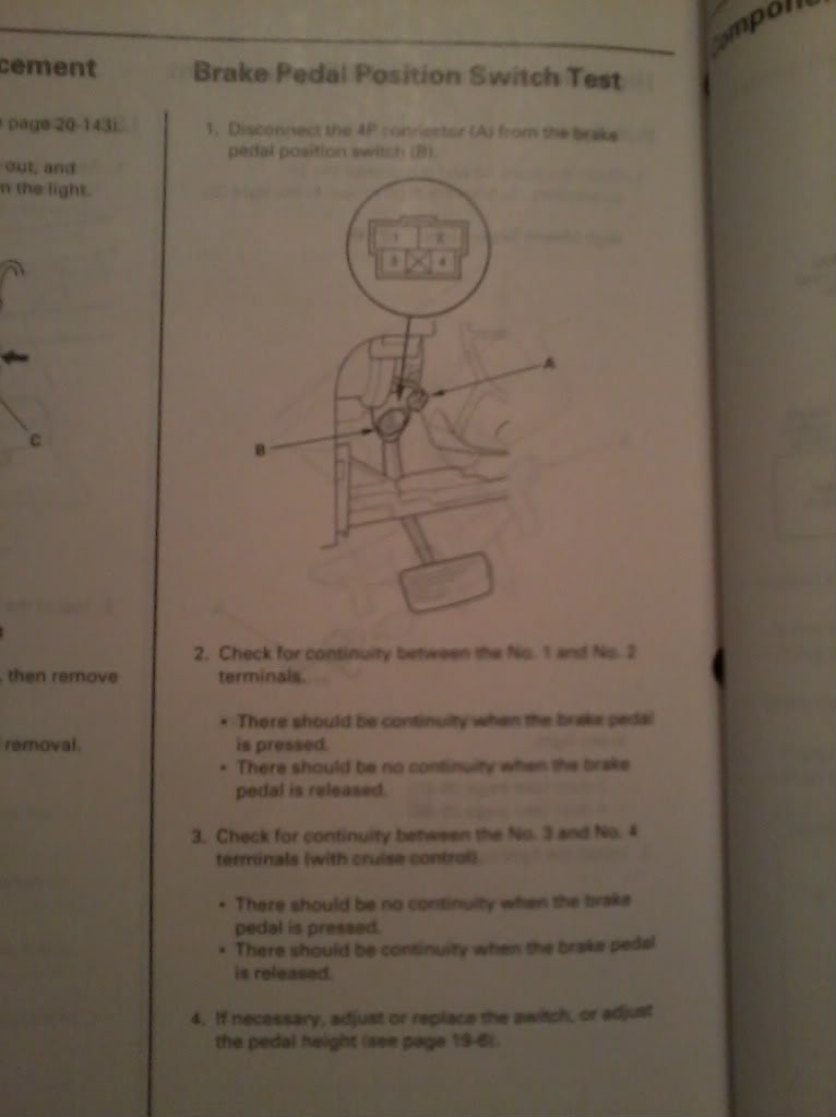

The CC could be several things- CC master switch, steering wheel switches, brake pedal position sensor, clutch pedal position sensor (manual tranny), transmission range switch (auto and CVT trannys), or the CC unit itself (except D17A1 and D17A2 coupes)
First, are the brake lights even working? The CC won't work if the brake lights don't work.
Second, look for bad wires/connections at each switch, the CC unit under the dash and, the actuator in the engine bay.
Third, if it isn't one of those then do the brake sensor test/adjustment. If the sensor is good then post back and I'll give ya the other tests.
brake pedal position sensor test:
