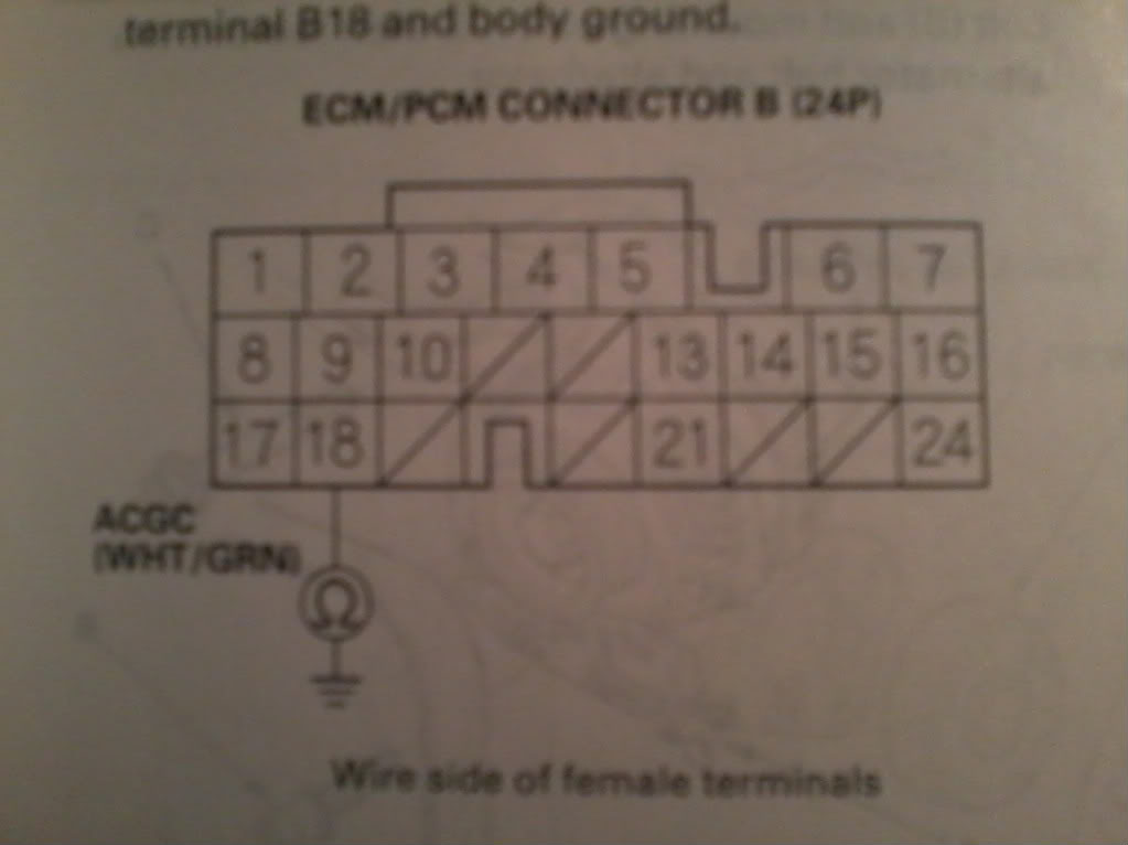

After some research: Inspect the white/green wire between the alt and ECM connector B:
***DO NOT CHECK THAT WIRE FOR CONTINUITY.***
You have to have an HDS (Honda Diagnostic System) to jump the SCS line or you will fry the ECM/PCM.
