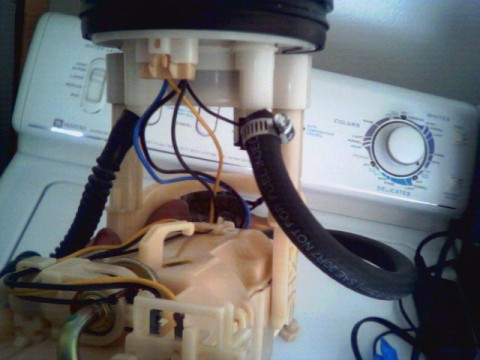

Re: Installing return style fuel pump
What is the purpose of running the hose like this? Is this the way it comes stock ( I have not taken mine out yet)
